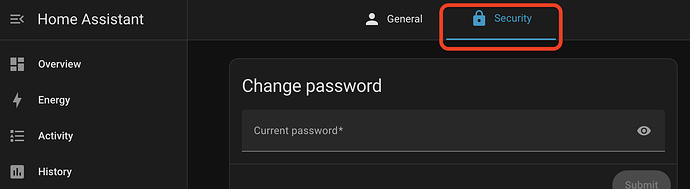

  1. Press on your user account in Home Assistant
    Screen Shot 2021-03-03 at 6.51.37 PM
  2. Select the Security tab at the top
  3. Scroll down to the bottom and select CREATE TOKEN

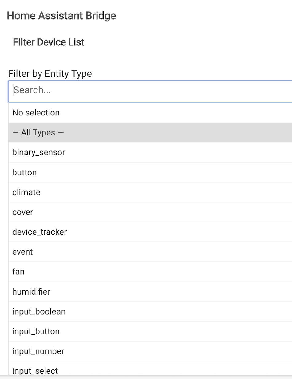

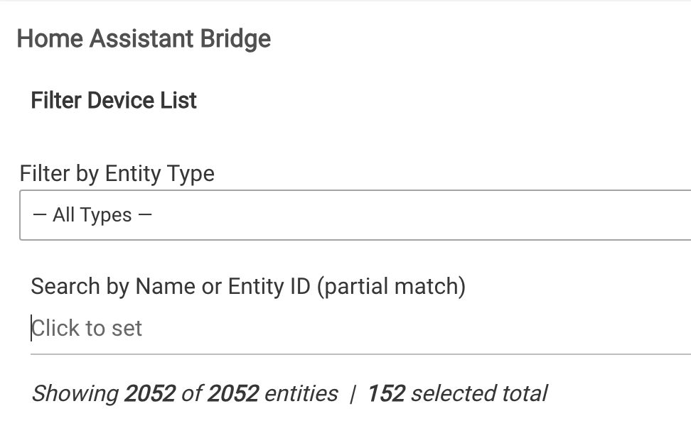

Filter by Type or Search by Entity Name or ID
Starting with HADB 2.20, you can now filter by Entity Type, or use the search field to narrow the results by Name or Entity ID
  1. Confirm and adjust which devices should be imported. You can adjust this later if you make a mistake or change your mind.
