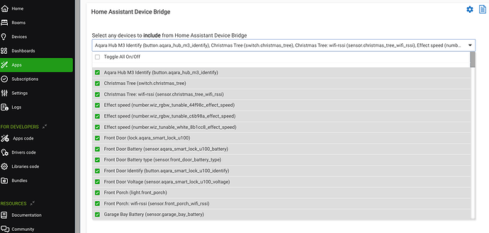

Looks like you have the Toggle All On/Off checked and not the actual devices.
Could be some sort of bug with the updated UI, not sure.
Check the device list in the Integration App.
Yeah I tried removing all devices, and re adding some devices, still not working. I’ll try removing the bridge and driver and reinstall it. Maybe I’m missing something in the install.
In the device list make sure this top entry does not remain checked, that is what the error is complaining about.
You might need to uncheck it and then select all the devices one by one. Could be a bug in the UI or in the app itself. I dont want to click it and mess up my selections but maybe I will set it up on my dev hub so I can try it out.

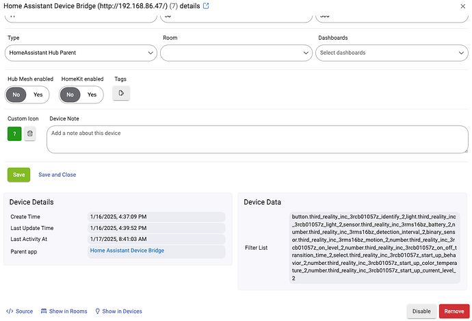

Please post a snapshot of the device data for HADB device. (HADB device --> device info, device data, FilterList at the bottom right)
Nice I did not realize that was there.
@mjtruncale should look something like this:
I went in and unselected everything, and then only selected a single light, and a single motion sensor in the Living Room. It has a bunch of attributes, assuming I select all of those. I then went and triggered the motion sensor and light. Checked Hubitat, and now I see those two devices.
So maybe one of the devices I had selected (I initially selected everything) was throwing the error. I'll add one device at a time, trigger it, and then verify it gets added to find the trouble device. Thanks for your help @jtp10181
From the error, it looks like the "Toggle All On/Off" was included as a device in the list to subscribe to. Which is kind of odd.
I wanted to see if and how it is included in order to fix the problem. But if you select device one by one instead of ticking the All device option, the problem won't occur, hence the list will not show it.
There is no device at fault. If you don't use the Toggle all option, you can select all the device you want in one shot.
