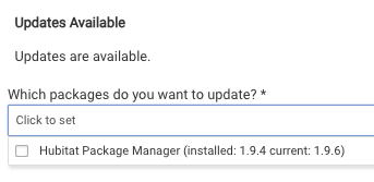

Same. C7. HPM showed there was an update (for HPM), I've ran it and it's just stuck on the below screen for 10 minutes now:
If you see the
It won’t finish, just go to repair at that point.
