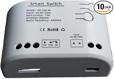

Hi @kkossev, many thanks for your work on this driver. It solved the problem on my 2CH 7-32v 2ch Zigbee Relay Module with both channels turning on when only one of the channels (child devices) was switched on however I have a further issue where I wish to use it in inching (momentary mode).
I changed to momentary (inching) mode using the mode button on the relay module however the ON duration is not long enough for my use case. Is there a way to increase the ON duration to around 3 secs, its currently only a second or less?
I note the Tuya app has this functionality for adjusting the duration when the module works via a Tuya zigbee hub so perhaps this could be implemented on your driver?
41EFv0fsRXL.AC_SX450_PIbundle-10,TopRight,0,0_SH20
