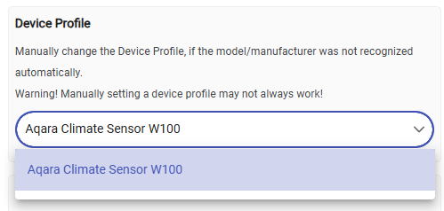

Device Profile - Manually change the Device Profile if auto-detection fails
  • Options: Aqara Climate Sensor W100

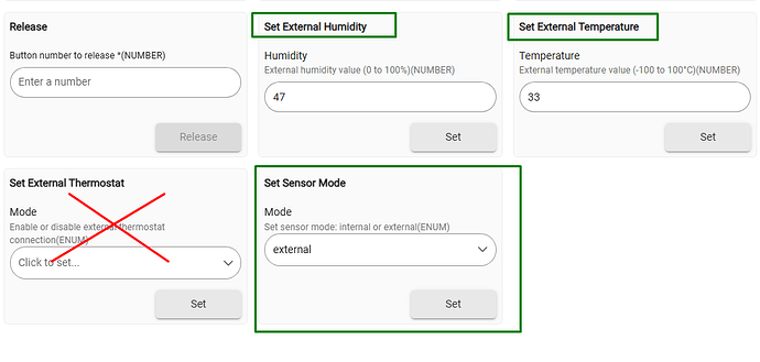

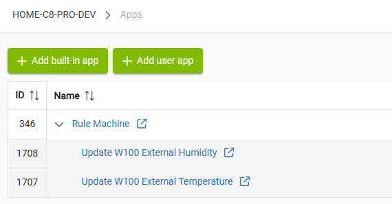

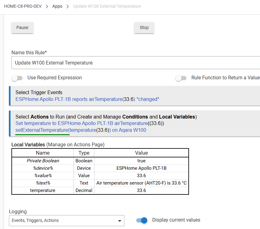

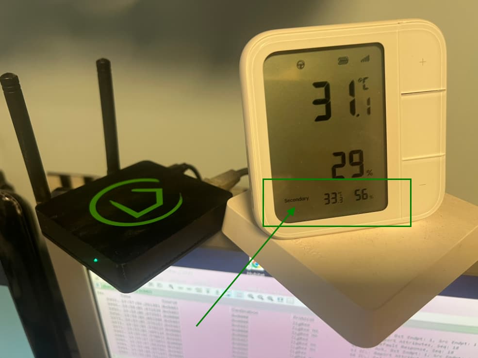

Good news! After many attempts, the secondary Temperature and Humidity sensor has shown up in HE! :tada:
