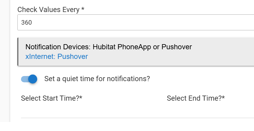

This is how to reproduce:

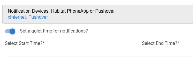

If I choose to set a quiet time, I get no field to put in the time (as mentioned):

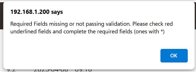

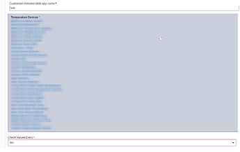

When I leave this "enabled" and hit Done, I get the error mentioned and red highlights around some fields:
Sorry this is happening. I have to admit I really have no clue here.
Have you been able to create other groups without using quiet time? if not,
can you please create another group and just add one device and only select Pushover to see if that works. Don't set a quiet time and see if you can create that group.
If that doesn't work, would you be willing to remove the app and re-add the app making sure you just click done to complete the install. Then again add only one device, only Pushover, and that's all. See if a basic option will work.

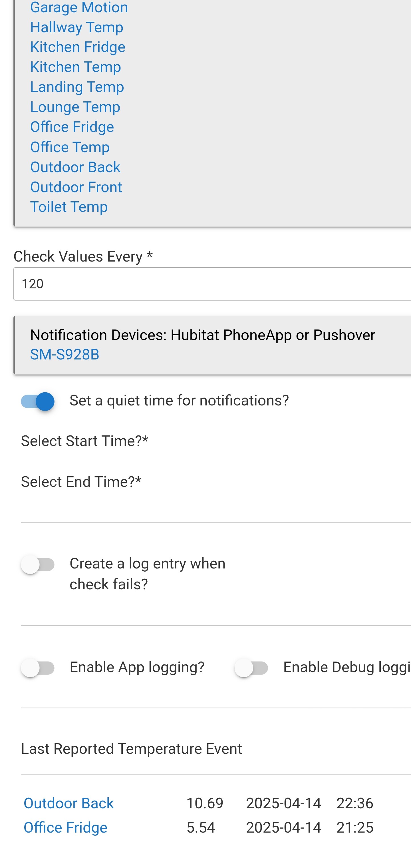

I confirm, same issue - if I try to set a quiet time, no editable fields appear to put start /end times in - exactly the same as @Kulfsson. I can create wothout setting a quiet time, though.
Thanks. I just submitted an update to see if this could fix this. Can you please do a HPM Repair to get the new update. I did not change the version number for this test.

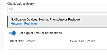

Nope, sorry! Not fixed. What it has done, however, is slightly change the layout - as attached - now shown one above the other rather than next to each other. Still no editable fields, sadly.
Thanks. Would you please try another change I just made to remove the imbedded if statements to see if that would make any difference.
Do another HPM Repair
Sadly still the same. No fields to enter those parameters, but the labels show up.
Thanks for all your help here. I just did another update and changed some syntax on those input fields that I hope works.
Will you please do another HPM repair and see if this works.
Apologies, completely missed this! Have just done a repair and.....Success! Fields appear for the Start/End of quiet time! Many thanks for your perseverance!
Thank you so much. I am so glad it is fixed.
