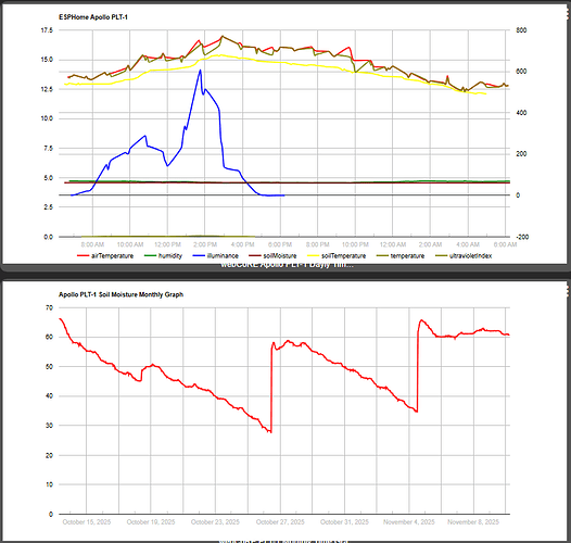

Hi @kkossev,
How has this sensor been for you? has it been accurate and consistent? Does it report data that follows typical soil humidity measurement curves?
Lamda
Hi @Lamda,
The Apollo PLT-1 sensor appears to be reporting soil moisture correctly — see the second (monthly) graph, which shows consistent and realistic soil humidity trends over time.
Thank you. I only wish it was weather resistant for outdoor use!
Do you use fertilizers or soil additives? Have you noticed any interactions?
I have found that humic acid supplements can cause the blue covered Tuya sensor and the tube shaped Tuya sensor to report 100% humidity for a long while until the supplement dissipates.
Not entirely surprising I guess, when considering how humic acid is supposed to work but another anomaly to be aware of.
Lamda
No, I haven’t used any fertilizers or soil additives, just tap water — but indeed, such additives will definitely change the soil’s electrical conductivity, and as a result, the measured humidity will appear much higher.
On the second graph, the slope is smaller than in the previous watering cycles because my wife installed a small water reservoir that drains very slowly over several days. The sensor is placed in a small pot located on the balcony — that’s where I had a convenient power outlet available.
