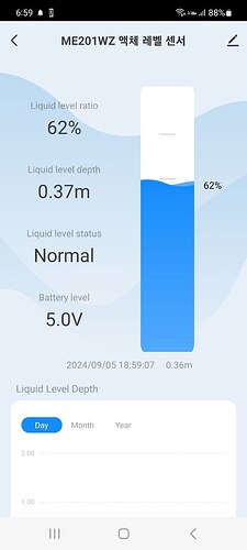

Hello, kkossev
I received this sensor today, and I am posting the connections to HE and tuya.
Device pairing info
Manufacturer: _TZE284_kyyu8rbj

Update: I see now there is inconsistency of the distance measurement units - the measured 'liquidDepth' is in meters, while the configured 'installationHeight' is in millimeters... It may be better if all the installation height is shown in meters?
I conducted a simple test on the Tuya app today.
If you fix only the upper part well, the lower part works well without a case.
This is the log file after connecting to HE.
I tried to adjust the height like the picture above.
