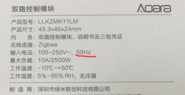

| Aqara Two-Way Wireless Control Relay | In-Wall Switch (no Neutral) | LLKZMK11LM | lumi.relay.c2acn01 | from guyeeba |
