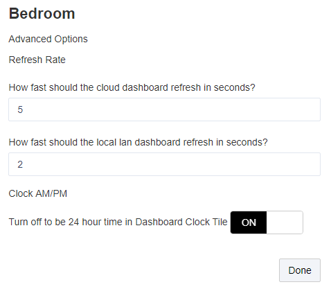

Heading back over to the Dashboard Child app. At the bottom of this you will have an option for Advanced Options.
You can adjust the Refresh Rate for the dashboard for cloud and local links.
You can also set the Clock templates to display time and date in 24 hour and EU Date formats.
