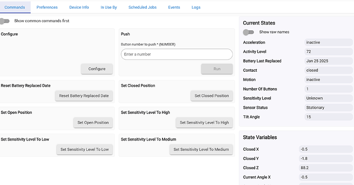

Hi, I ordered a bunch of Aqara vibration sensors (model # DJT11LM). They were tricky to pair, I paired most of them to the closest zigbee repeater that they'll be installed at. I paired a few next to the hub since they'll be installed within 10ft. I got them to pair after holding the Aqara pair button after entering Zigbee pairing mode. Once they went to "device found" I hit the button every five seconds or so to kind of keep them awake. If I didn't do the second part, they just get stuck at the "initializing" part. Tested them, and then changed the driver to " Xiaomi Aqara Vibration Sensor" found here :Aqara Vibration driver - veeceeoh

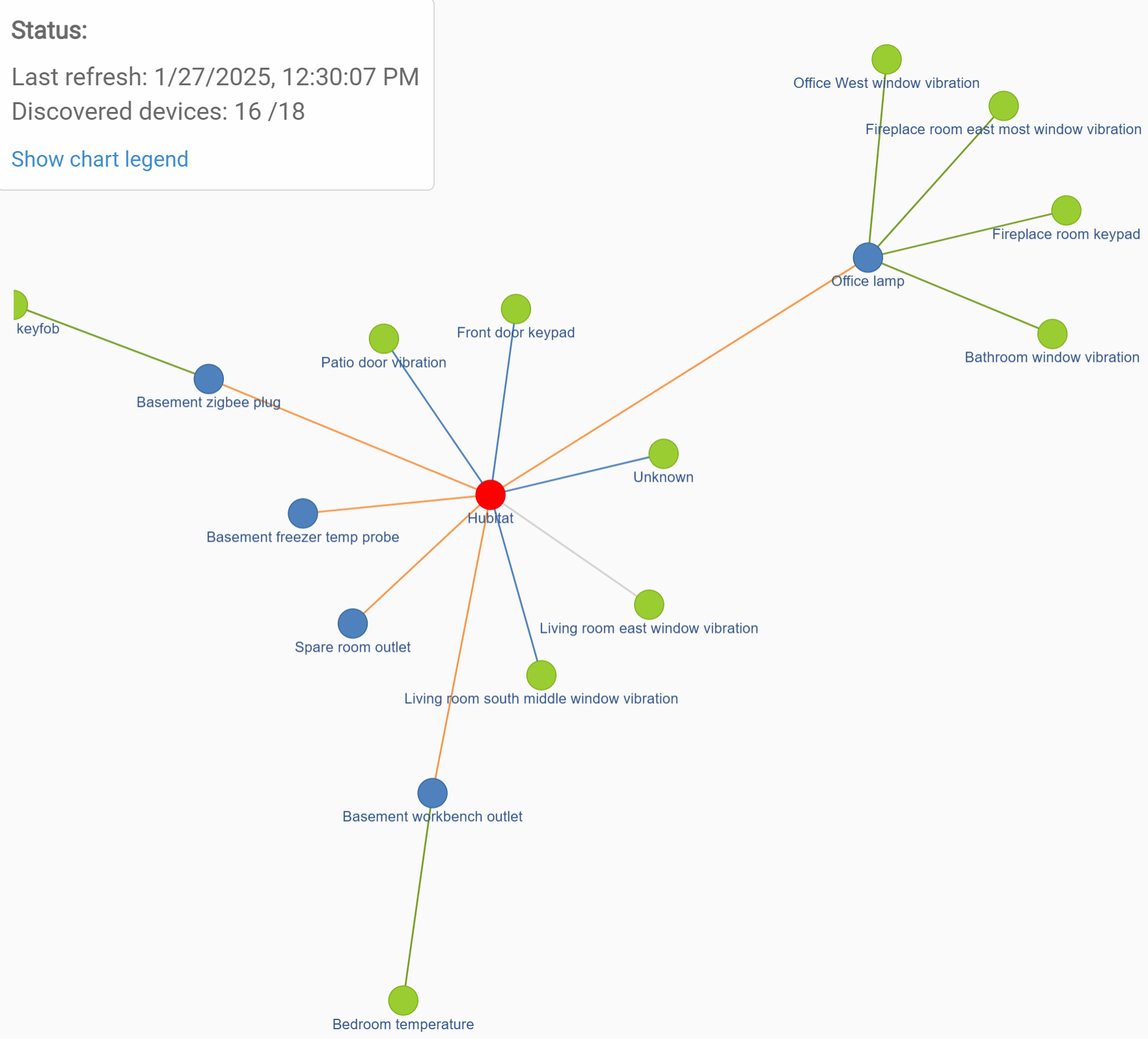

Most of them seem to function fine, but a few don't seem to stay online. I plan on using them for vibration sensors on windows to integrate into HSM. They're all pretty close to my Ikea Tradfri plugs/repeaters. If it's relevant, I have my Zigbee radio power level set to 20, in a clear channel.
Maybe I should have gotten different sensors, as it seems people have had good luck with the Tuya vibration sensors. I should have researched more, but here we are lol. I need about 10 sensors, so I didn't want to spend $20/ea, and the Aqara sensors were affordable bought in bulk.
Any tips with these sensors? Was debating putting all new fresh energizer batteries in, no idea how old the ones that shipped with them are. Wasn't sure if doing the Zigbee rebuild network option would do more harm than good. I attached the zigbee graph tool, not sure how accurate it is, as well as how I set the devices up. Some show sensitivity level as medium, others as unknown. Any help is appreciated, thanks.

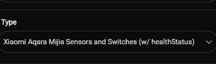

I also don't use the drive you have chosen. I use this for every Awara device.

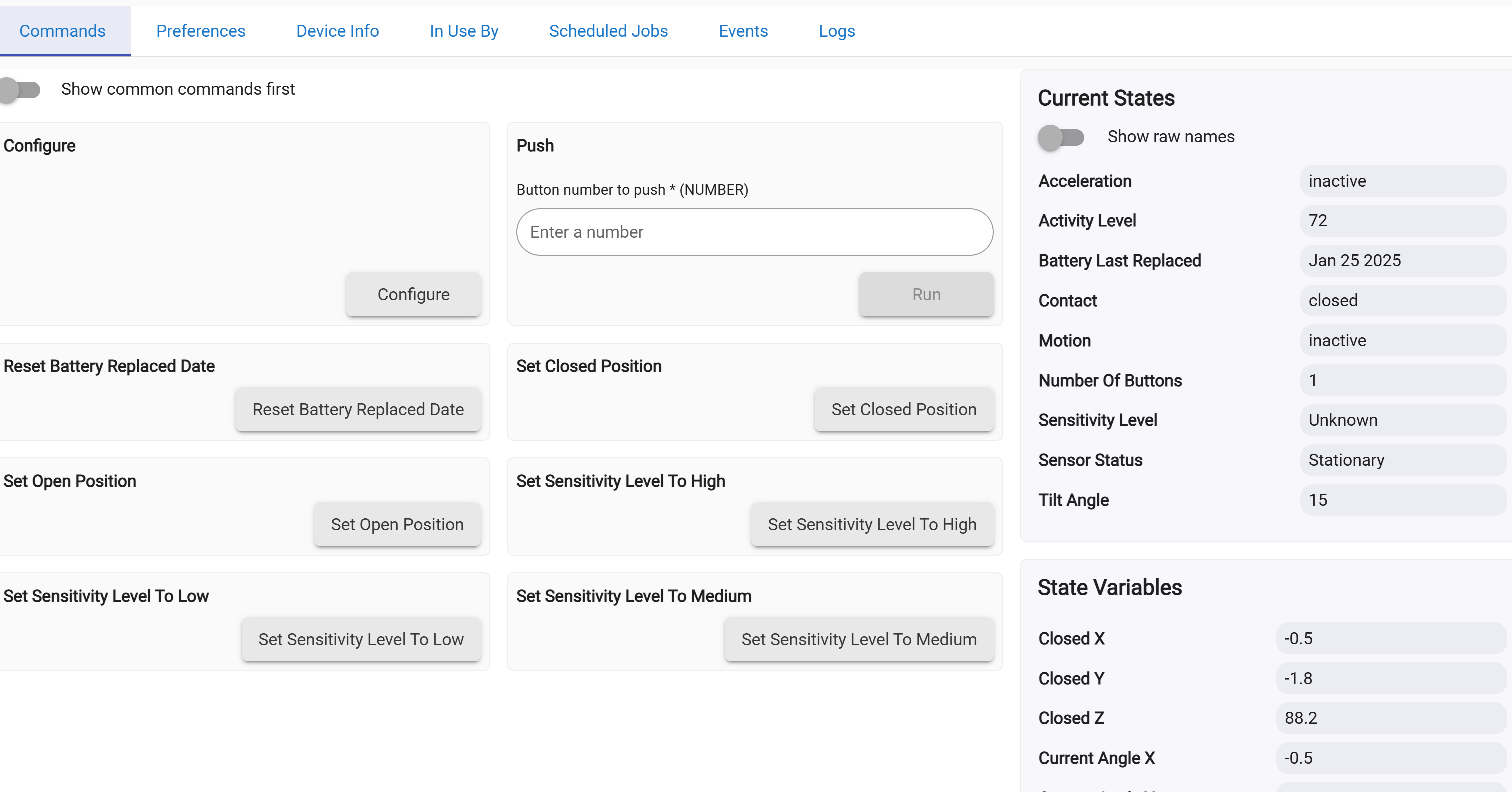

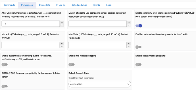

Interesting, does that driver seem to let you change the sensitivity settings, and do you think the battery level reporting is fairly accurate?

There are no sensitivity settings in the driver I use.

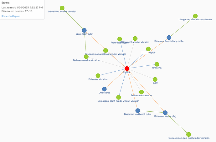

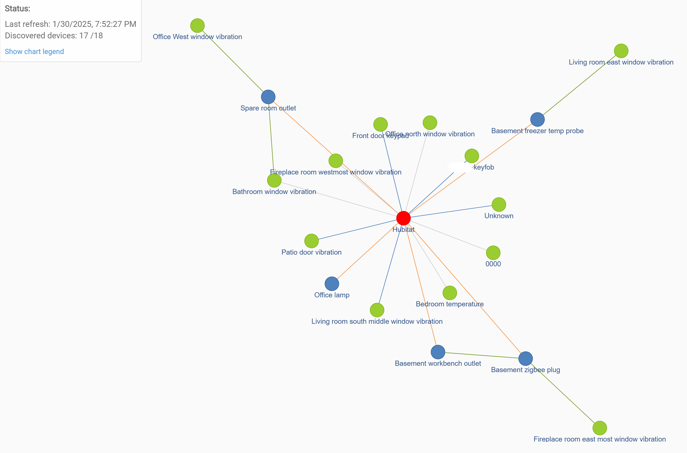

After running around my house, and banging on all the windows this is what the zigbee graph looks like. I was pairing them right on top of the "office lamp", but it doesn't seem to route them through it for whatever reason. I also see there's a device now just labelled "0000".
If you have well-positioned repeaters (just use your own common sense for this - no fancy tools necessary) and your devices are all working fine, don't worry about those network maps or what's connecting to what.
It's not information worth obsessing over.
