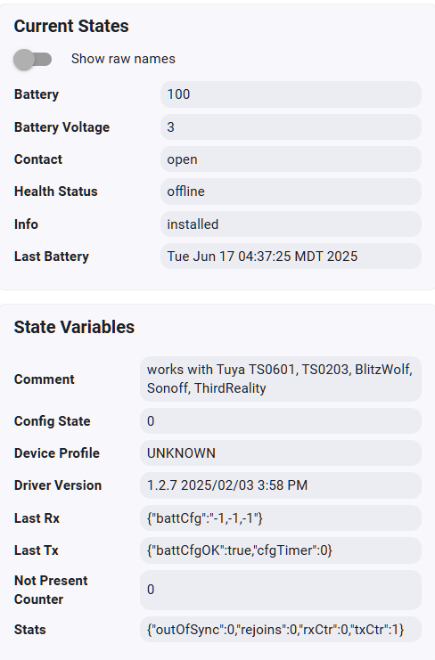

Tuya Contact Sensor+ with healthStatus Version 1.2.7
Device is
I bought a Maxcio Zigbee Door Window Sensor for use with Hubitat. It's identified in HE as Manufacturer _TZ3000_bdoswav6 and Model TS0203. I could not get it to work with the default driver so I installed this one (Tuya Zigbee Contact Sensor++ w/ healthStatus v1.2.7). After repairing, all seemed to be well. I moved it to its final position where it stopped responding and despite multiple successful repairings from that position, it still would not report any status info.
So I moved it back next to HE 2.4.1.177 where it still will not report. I've repaired it many times. I tried a second identical device. It also pairs successfully but stays offline and won't report status.
Any thoughts on what I'm doing wrong or might try? Thanks in advance.

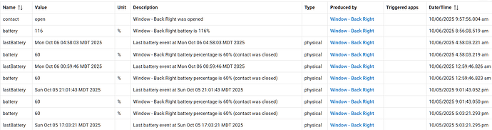

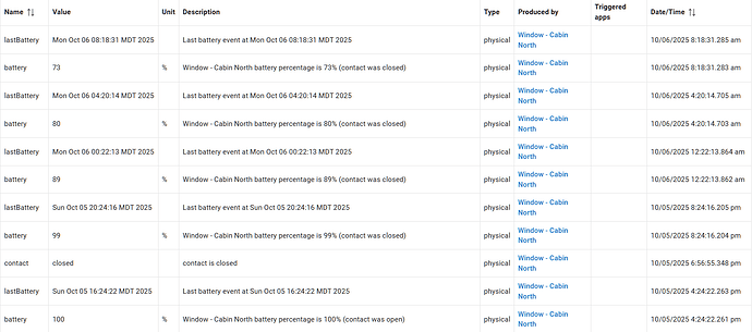

I'm having trouble with Zigbee door/window contact sensors battery life or battery reporting. I bought some Maxcio brand sensors that Hubitat identitied as Manufacturer: _TZ3000_bdoswav6 and Model: TS0203. I installed/configured the Tuya Zigbee Contact Sensor++ w/ healthStatus driver. Overnight, the Battery percentage on these drops from 100 to in the 70s. It continues to drop and goes to 1 within a few weeks. I've tried a different brand of battery with the same result. They're within a few feet of the hub or a repeater. There's very little open/close activity. I've read multiple posts across the internet without finding a solution.

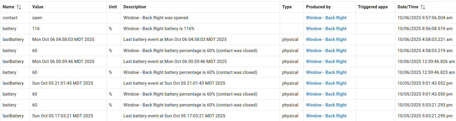

Today, I tried the Generic Zigbee Contact Sensor (no temp) driver and the Battery went from 60% to 116% after configuration. This makes no sense to me but suggests the issue might be reporting instead of actual battery life.
Example of a new one dropping overnight:
And here's the one going up from 60% to 116% after changing to generic driver:

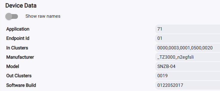

A ZM-CG205 (identified as eWeLink SNZB-04) that I installed yesterday isn't exhibiting the same behavior.
Does someone here understand the problem? I'll stick with the generic driver and see what happens over time.
Edit: I had forgotten the reason I used this Tuya driver originally. The generic driver fails to detect open/closed status. That's another problem for which there does not seem to be a consensus answer.

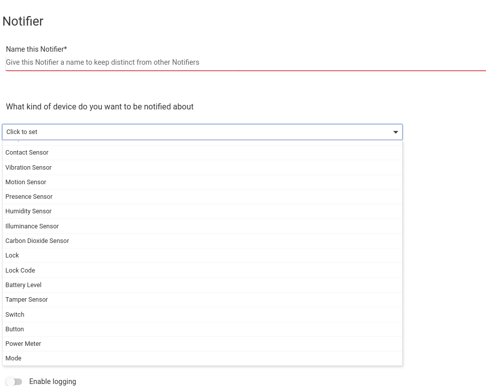

I just started using this driver and am happy with it. I've been trying to setup a notification rule for if devices go offline but can't come up with a clean way since healthStatus is a custom attribute you can't multiselect devices in rule machine. Ever consider changing healthStatus to presence so built in notification apps will work with it? Cheers!

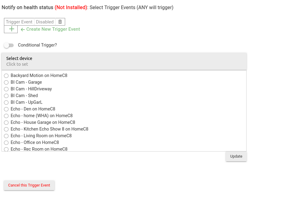

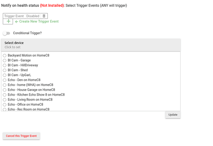

I would like to be notified if one of the devices healthStatus goes offline.
But built in notification app doesn't support that.
And you can do it in Rule Machine with a Custom Attribute for the trigger, but you can only select one device at a time. So you'd need to add a bunch of triggers, or a bunch of rules, one for each device you want to monitor.
I tried using chatGPT to write a notification app for when devices go offline and I did get it working but you can't simply filter a dropdown list on devices that have a capability.healthStatus. My little app works, but you have to be careful to only select devices with the healthStatus attribute.

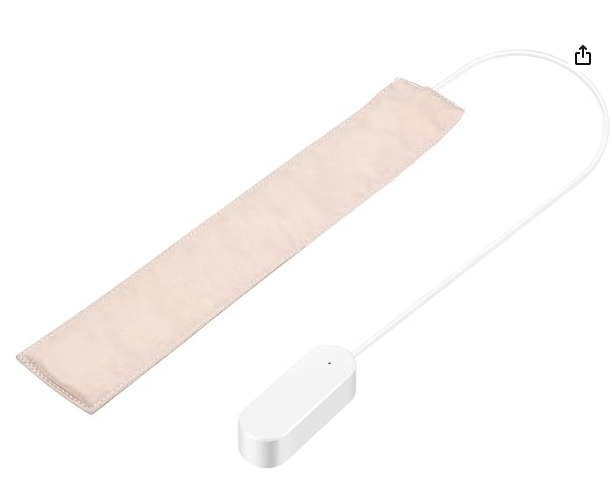

  • added TS0601 _TZE200_seq9cm6u/_TZE204_seq9cm6u pressure strip as contact sensor;
(Update manually or do an HPM 'Repair')
Links: Amazon AliExpress

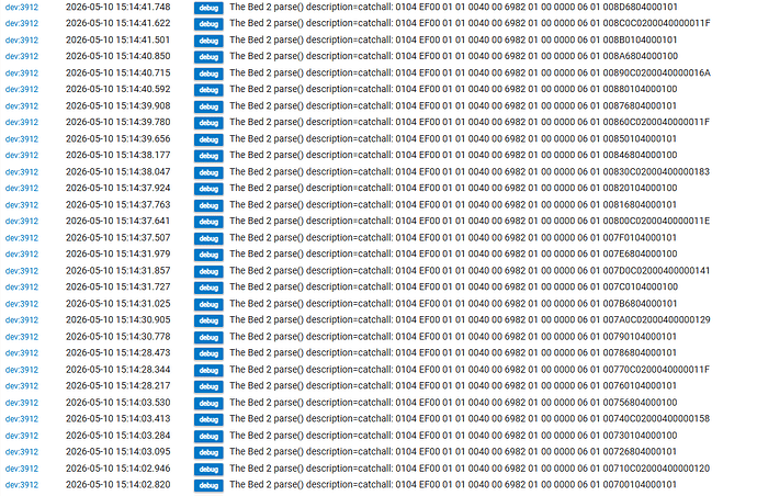

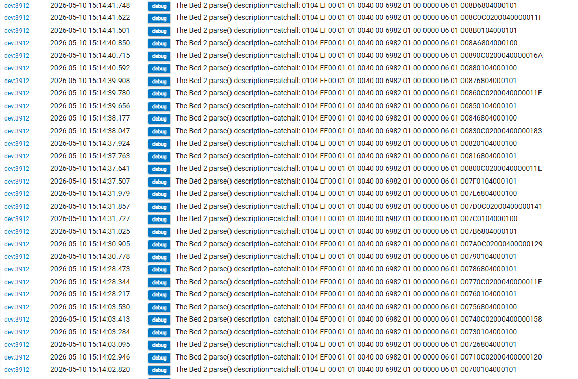

I don't know if it is me or not, but in the device page, the message to Wake the device will not go away...
and the contact status doesn't change, but in the log I see the strip working:
Here is a partial shot of the debug log when I press and release the strip:

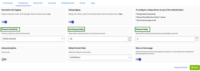

How does the strip determine open/close status, or do I use the pressure value in a rule and perform a comparison to determine my own open/close or present/not present?
