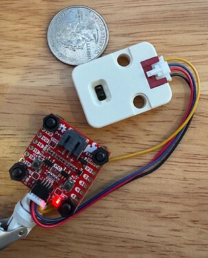

I've been on a mission for a while to build a car presence sensor. My previous efforts:
I wanted to couple the Arduino Uno R4 WiFe board that I had with an Xbee with Zigbee capability, but that seemed daunting based on what little I could find on the internet. So I moved on to a more integrated (and compact) solution, the ESP32-C6 Qwiic Pocket board, which has Zigbee capability, paired with a VL53L1X TOF sensor. Using a Grove/Qwicc cable, no soldering was required.
Marrying the ESP32-C6 Qwiic Pocket (EQP) and VL53L1X sensor was easy, I just ported over my distance measuring code from the Arduino hybrid. But getting Zigbee working with Hubitat still seemed a huge challenge. So I asked Claude (AI) to show me any working example of an ESP32 (of any kind) paired via Zigbee with Hubitat -- and Claude found one!
It didn't work of course.
BUT it held clues. One important finding was that no amount of effort on my part could get pairing to occur with the EQP set as an end-point device. BUT experimentation showed that with the EQP set in a coordinator/router mode AND using Double-Luck Voodoo (see here: [RELEASE] Tuya Zigbee Contact Sensor++ w/ healthStatus - #70 by John_Land), the EQP paired to Hubitat!
So over the course of a couple of late nights, Claude and I drafted (1) a Groovy driver that grafted distance measurements onto a pre-existing illuminance driver, and (2) embellished the EQP sketch to add features and robustness. I also heavily document the sketch.
Everything works great on my test setup, next steps are to find an enclosure, connect up unit #1 to my garage ceiling, and start putting together unit #2.

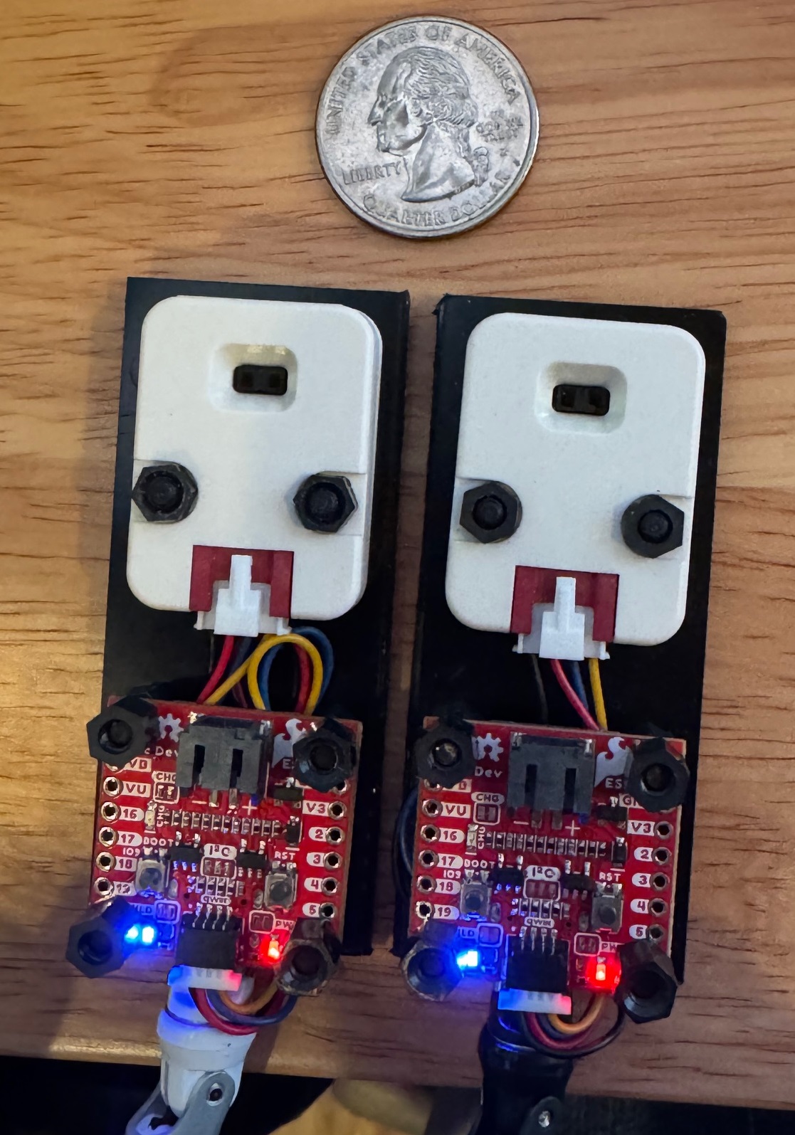

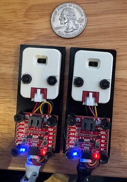

EDIT: I found out a few minutes ago that the v1.0 sketch won't work if the EQP is powered by a "power only" USB-C cable. Version 1.1 fixes that, now a power-only or a power&data cable should work.

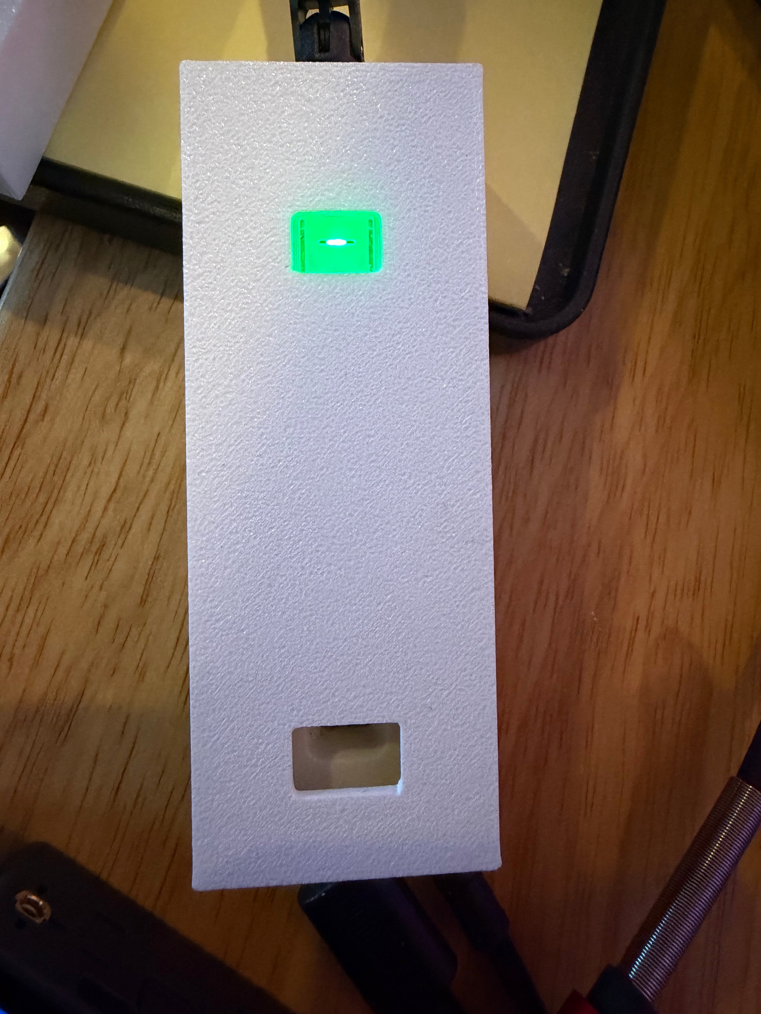

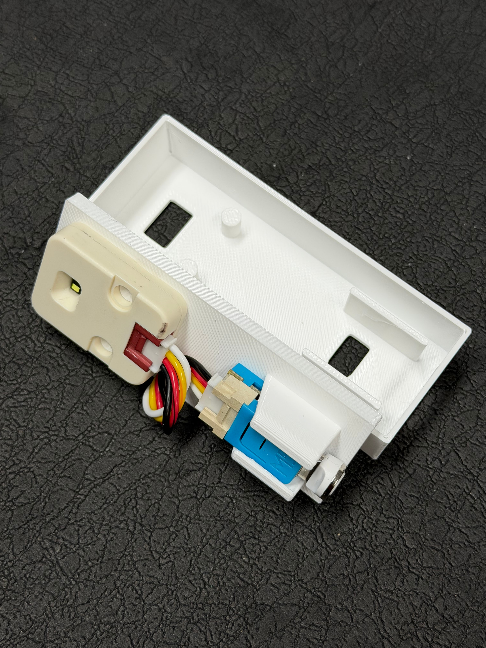

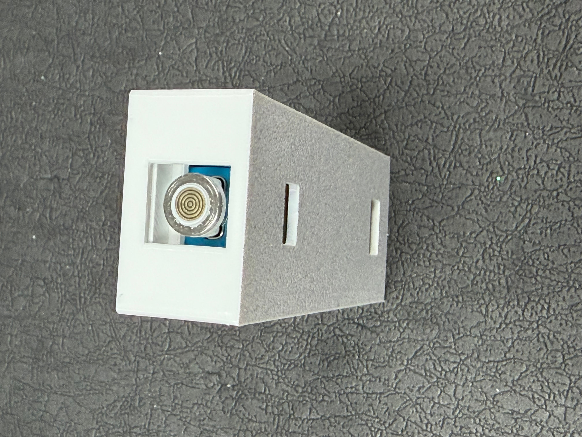

2025-10-30: Still haven't found a suitable enclosure, so I mounted the ESP32 and TOF sensor on a strip of kydex. These are ready to install on my garage ceiling, one for each car.

  • Now runs on a SparkFun ESP32-C6 Qwiic Pocket board (no display) and an Arduino Nesso N1 board (with a display showing distance).
  • More robust Zigbee pairing and stability because WiFi is only turned ON when an over-the-air (OTA) update is needed (but pair by rebuilding your Zigbee network twice in a row, then "Pair while trying to avoid Zigbee 3.0 repeaters").
The ESP32-C6 Sketch, Groovy driver, documentation, and ancillary files may be found here (the files are too big to post here and ZIP files are not allowed here): GitHub - JohnFLand/ESP32-C6-LIDAR-Distance-Sensor: An Arduino IDE sketch for SparkFun ESP32-C6 Qwiic Pocket and Arduino Nesso N1 with a VL53L1X LIDAR unit, measures distances up to 4 meters and reports to a Hubitat Driver via Zigbee. OTA updates enabled over WiFi. · GitHub
NOTE: I'm new to GITHUB, so I have no clue whether I've posted and organized file correctly.

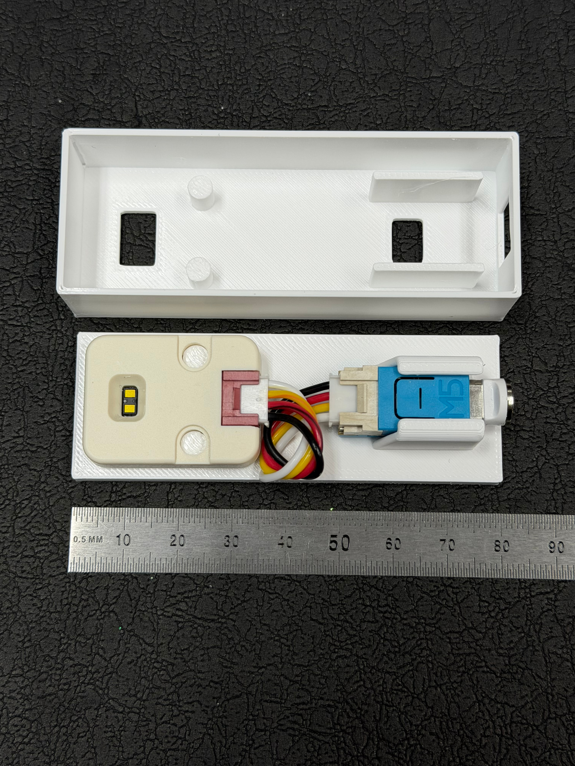

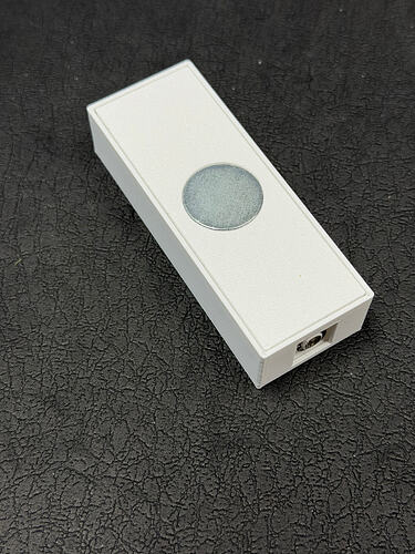

Photos of latest version, with custom 3D printed case. Power is via a USB-C connection to the M5Stack NanoC6 through a 9-pin magnetic adapter. No soldering required. The base plate has LEGO-style pegs to hold down the LIDAR sensor, and the cover has matching pegs. Printed in PETG (because that’s all I had at the time) on a Bambu Lab H2D. The back of the case has a recess for a 20mm diameter magnetic disk.

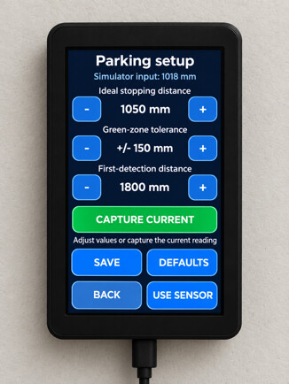

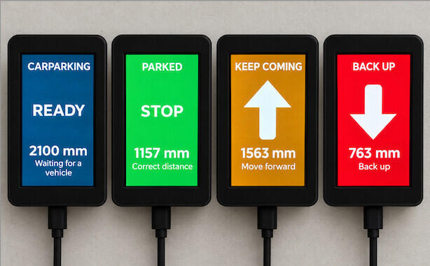

I've got several of the Waveshare ESP32-S3-Touch-LCD-3.5 and was looking for something useful to do with them. Stumbling onto this topic got me to thinking.. and I bought a little bag of Time-of-Flight sensors and connected it to the Display and the result is:
(that's one display showing the 4 distance range results.)
It's far more expensive, but I've already paid for them and repurposing one seems brilliant from over here. :smiley:
