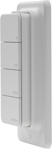

Driver for Shelly BLU RC Button 4 ZB -- UPDATED 2026-05-02
I bought one of the Shelly BLU RC Button 4 ZB scene controllers some months ago, but only got to playing with it today.
When paired (and it can be difficult to pair, Modified Double Luck Voodoo is your friend [RELEASE] Tuya Zigbee Contact Sensor++ w/ healthStatus - #70 by John_Land), the device is assigned the Nue Zigbee Scene Controller driver, which I could not make work -- no button presses ever logged. I could NOT find a working Hubitat driver for it anywhere.
So Claude and I worked for a couple of hours, based on my feeding Claude this information site: Shelly BLU RC Button 4 ZB | Shelly Technical Documentation
The result is the attached driver, which I hope saves someone else some time.
2026-05-01 UPDATE: Added scheduled health monitoring, a lastPushed timestamp attribute for pushed/held/doubleTapped events, and a "Last Physical Button Pushed" in Current States.
2026-05-02 UPDATE: Added Current States fields to show Triple Tapped and Double Long Held events rather than coding those events into the Pushed field.
