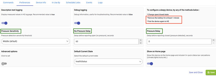

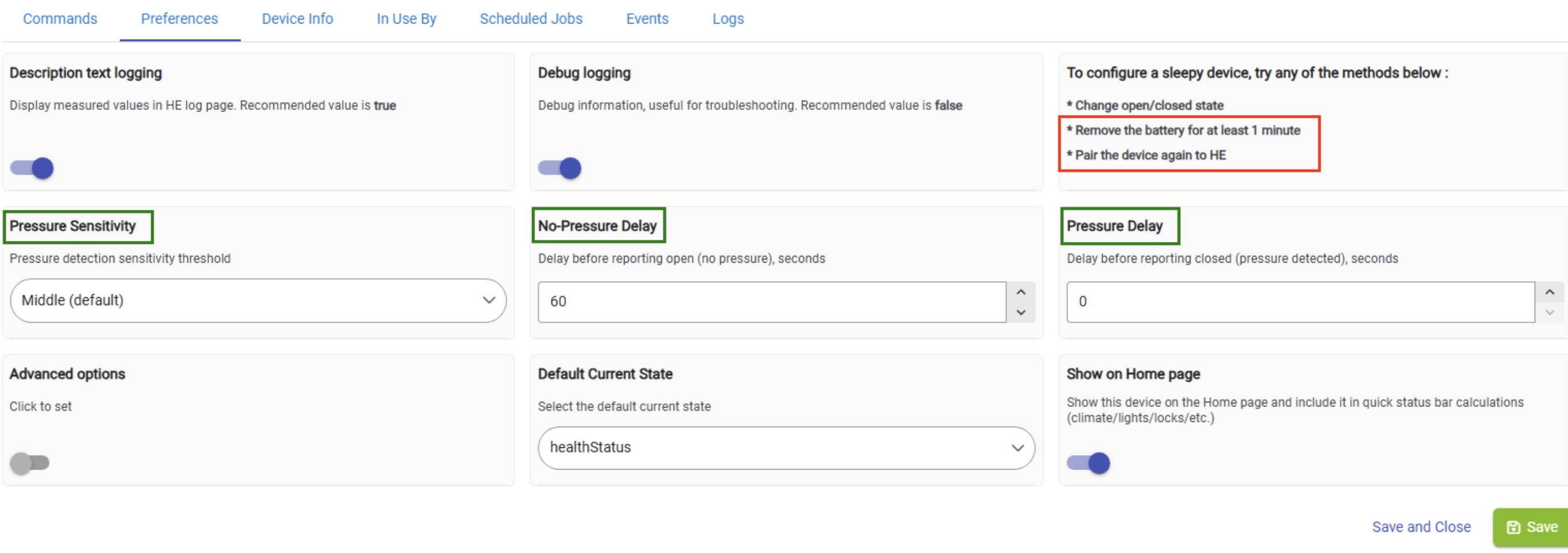

From Krassimir's screenshot above, did you try either of the things I circled in red here in the "To configure a sleepy device..." section?
Yes, I tried them all....

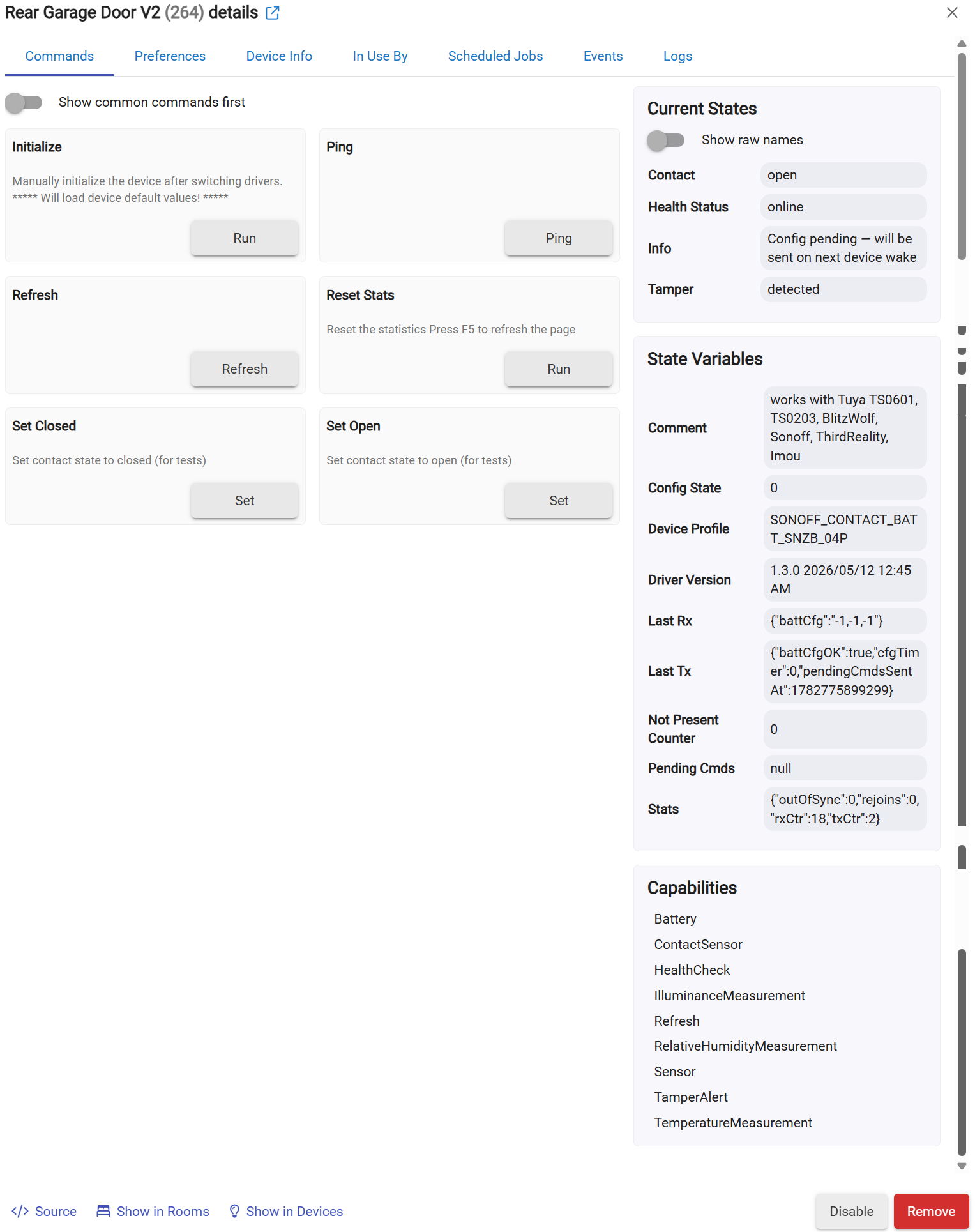

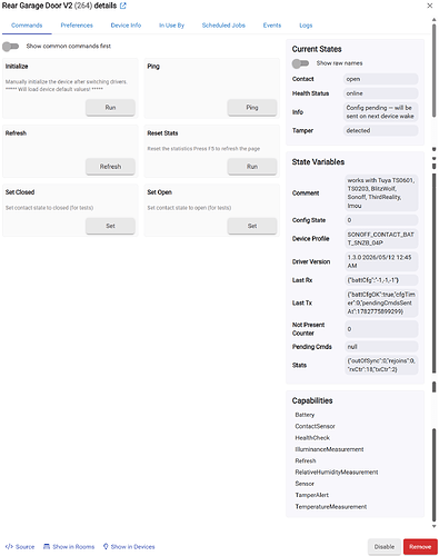

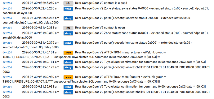

@kkossev , thankyou for a fabulous driver for these sensors! I have just been upgrading my old Sonoff early version contact sensors using the system Sonoff contact sensor driver with the new Sonoff SNZB-04P contact sensor with your driver vers 1.3.0 2026/05/12 12:45.
I notice on quite a few devices that I’m getting the below warning and on one device no battery stats are being reported despite removing battery and repairing to the hub.
Is there something a little different with this batch of sensors ?
