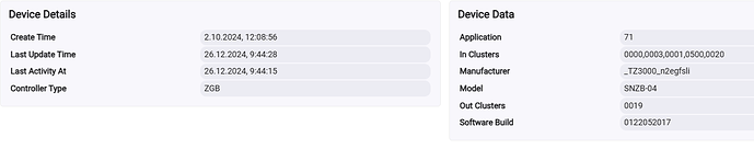

Device details:
Can you update manually the driver to the latest dev. branch version 1.2.6 2024-10-02 and test again whether the same error will show up?

Out of curiosity, I did see that driver is designed to work with the _TZ3000_n2egfsli just like mine but with different inClusters and outClusters, is this common? I was thinking the same model should use the same inClusters and outClusters.
This is cousing my deviceProfile to show UNKNOWN and the model SNZB-04
