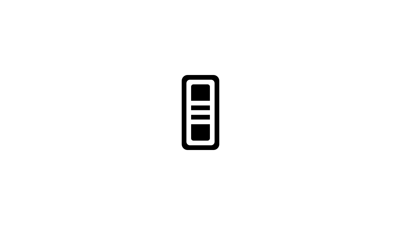

Updated a Sengled Color Plus bulb.
Failed 1st time (see red circled part below, weird that no device was listed on the 1st attempt?).
Worked 2nd time though.
