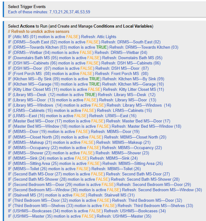

I know it's been a while, but I have the same issue with my Phillip Hue Motion sensors, and the following "Fonzy hit" is the only thing that I have found gets the the sensors "unstuck." It's not as resource as intensive as it would appear, because if everything is working this routine will do nothing or only refresh stuck sensors. At worst it may refresh one or two sensors that happen to be active.
