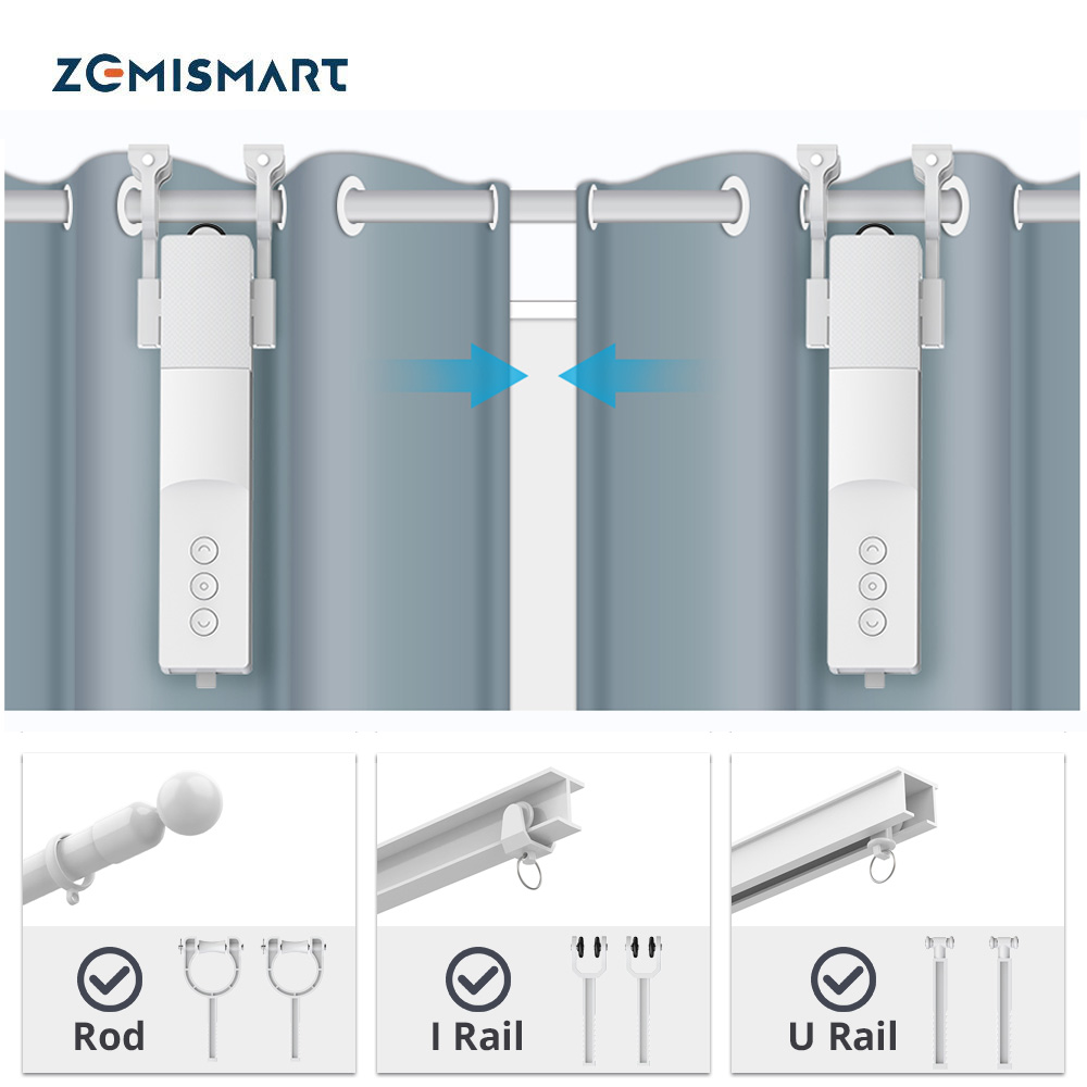

I'm using this driver for my curtain robot, which works ok so far.
