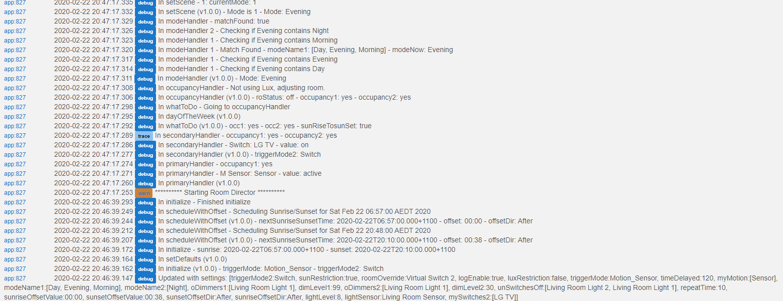

However does anybody use the time restrictions as for me they don't seem to work for both sunset to sunrise or if I use specific times?
Thanks, can you give me an example and logs?
Here's the log.
I used the offset to create sunset at 20:48 and at 20:47 motion would trigger the lights to turn on.
New version on GitHub...
