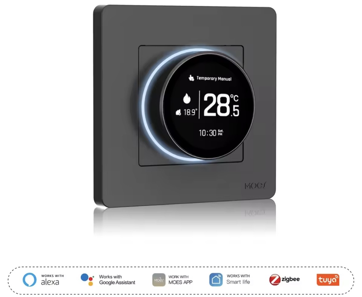

Ok, I have some ideas to try when I have the time next days, but I can’t promise anything. Unfortunately, I can’t find any information for this device on GitHub for now.
I'm just outside of the return window, but I guess I could get different thermostats if necessary. I was pretty surprised this is an entirely new implementation rather than another clone of something else.
I tried the Aqara W100 driver, and it shows the battery level but no commands seem to go through, and there's nothing in the logs when I operate the knob.
