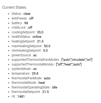

Now supported in the 'Tuya Zigbee TRVs and Thermostats' driver, version '3.3.3' '2024/08/01 9:50 PM'
Manual installation link :
https://raw.githubusercontent.com/kkossev/Hubitat/development/Drivers/Zigbee%20TRV/Tuya_Zigbee_Thermostat_lib_included.groovy
Looks nice!
(oops, the powerSource attribute is to be corrected to 'battery' in the next update ... )
