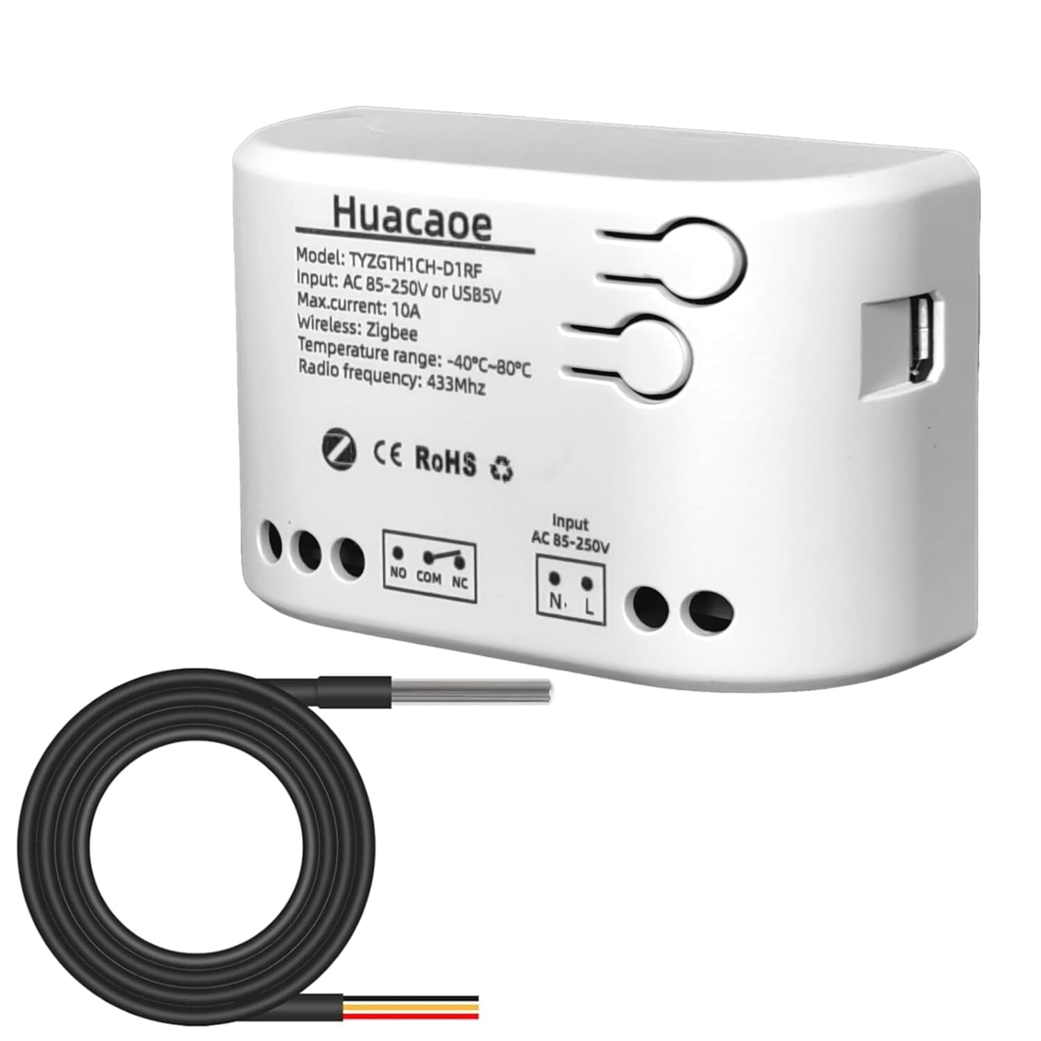

I am using DS18B20 with Apollo TMP-1.

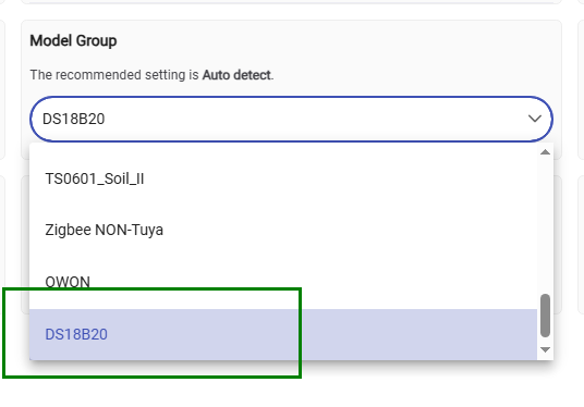

@jw970065, this device fingerprint is not in the driver (will add it on the next update), but you can manually configure the driver to use it : select 'DS18B20' Model Group in the Preferences tab :
There is also a dedicated driver for it by @lwbenso published here :
