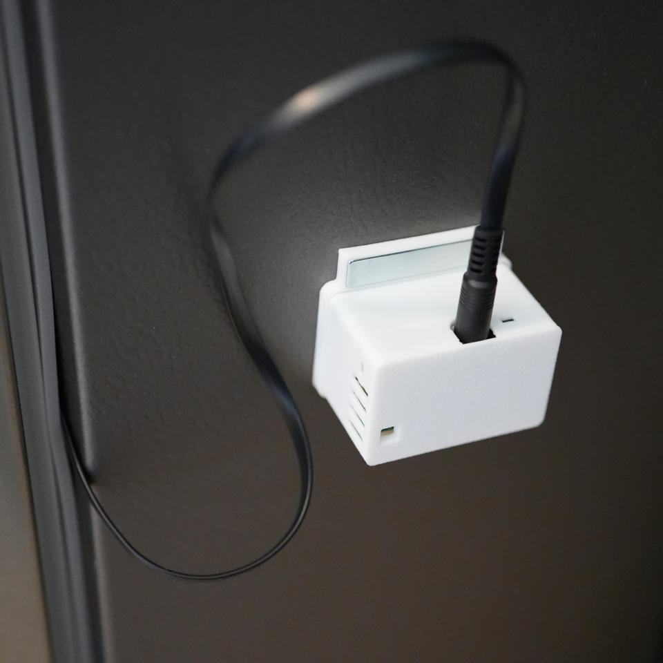

  • Mounting: Optional magnetic mount available

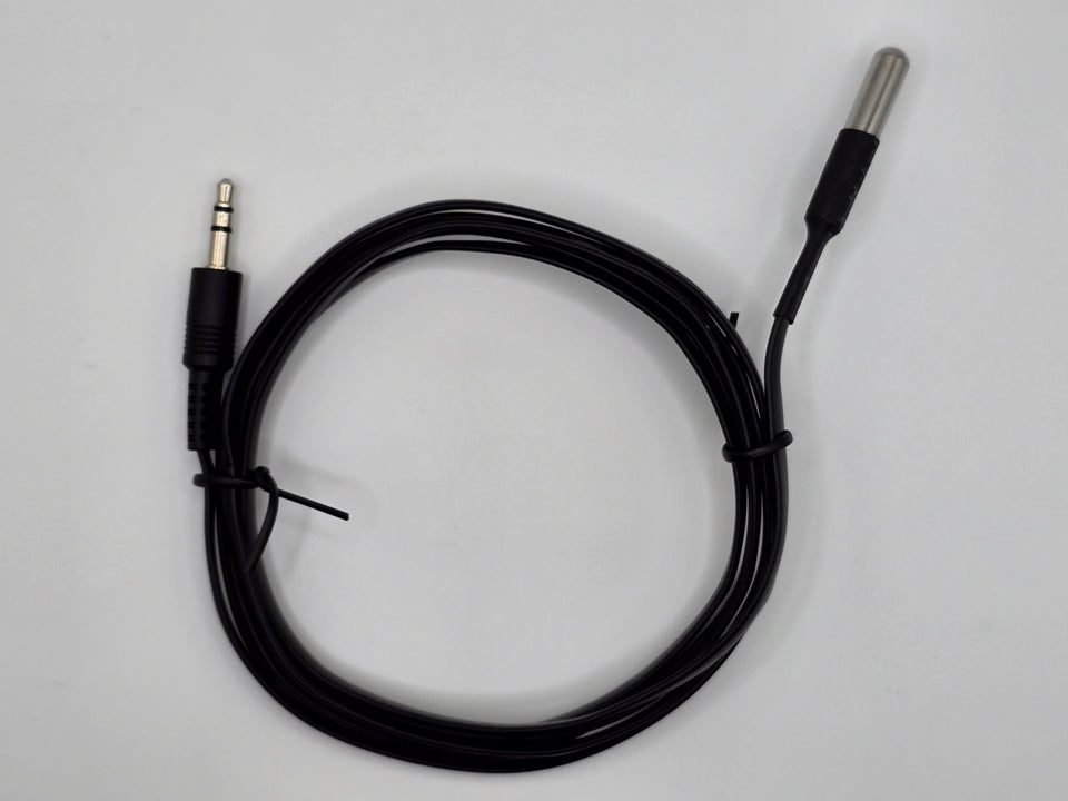

Temperature Probe Features:
• DS18B20 waterproof temperature sensor
• Available in 20cm (~8in) and 1.5m (~5ft) lengths
• Flat cable design prevents interference with fridge seals
• Submersible and waterproof construction
• Temperature Range: -55°C to +85°C (-67°F to +185°F)
• ±0.5°C accuracy
• Ideal for freezer, fridge, aquarium, and pool monitoring

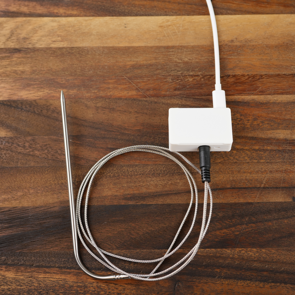

Food Probe Food Probe Features:
• 1m (~3ft) stainless steel food-safe probe
• NTC temperature sensor
• Temperature Range: -40°C to +204°C (-40°F to +400°F)
• Food-safe stainless steel construction
• Perfect for grilling, baking, and cooking
• Not dishwasher safe
• Real-time temperature monitoring for perfect cooking results

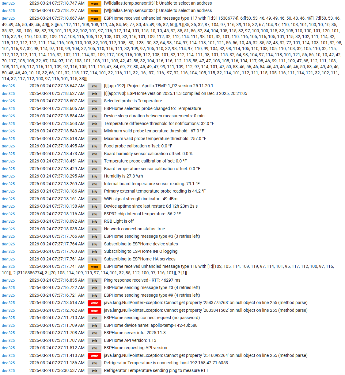

Thank you for making this available. I recently purchased the TEMP-1 probe to monitor my freezer. I have it installed with a temperature probe and it works fine, as long as I activate advanced settings and then Enable Diagnostic Attributes. If I do NOT enable the diagnostic attributes, I only receive humidity reports. While it works when they are enabled, I am also receiving lots of reports I don't need. Is there a way to get the probe temperature without enabling diagnostic attributes? In all cases, the unit says it is sending temperature probe data (looking at the log it displays on it's web interface page).
Thank you!
I spent the last several days trying to get the temperature to report with Diagnostic Attributes not enabled. Of course, shortly after posting my question above, I found that changing line 106 in the ESPHome Apollo TEMP-1(B) driver from:
'temperature_probe': [attr: 'temperatureProbe', isDiag: true, type: 'temperature', description: 'Primary external temperature probe reading'],
to:
'temperature_probe': [attr: 'temperatureProbe', isDiag: false, type: 'temperature', description: 'Primary external temperature probe reading'],
Seems to fix my problem. If this is not a wise change, please let me know!
Thank you!
Thank you for catching this bug :lady_beetle: in the code, and yes, your fix is the correct one!
I will include it in the next driver update.
If you have any proposals for improvements in this driver , don’t hesitate to share your ideas.
Update 09/28/25: The fix is included in the "ESPHomeApolloAutomationDrivers" bundle version 1.0.3
Thanks! It's been working great!

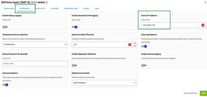

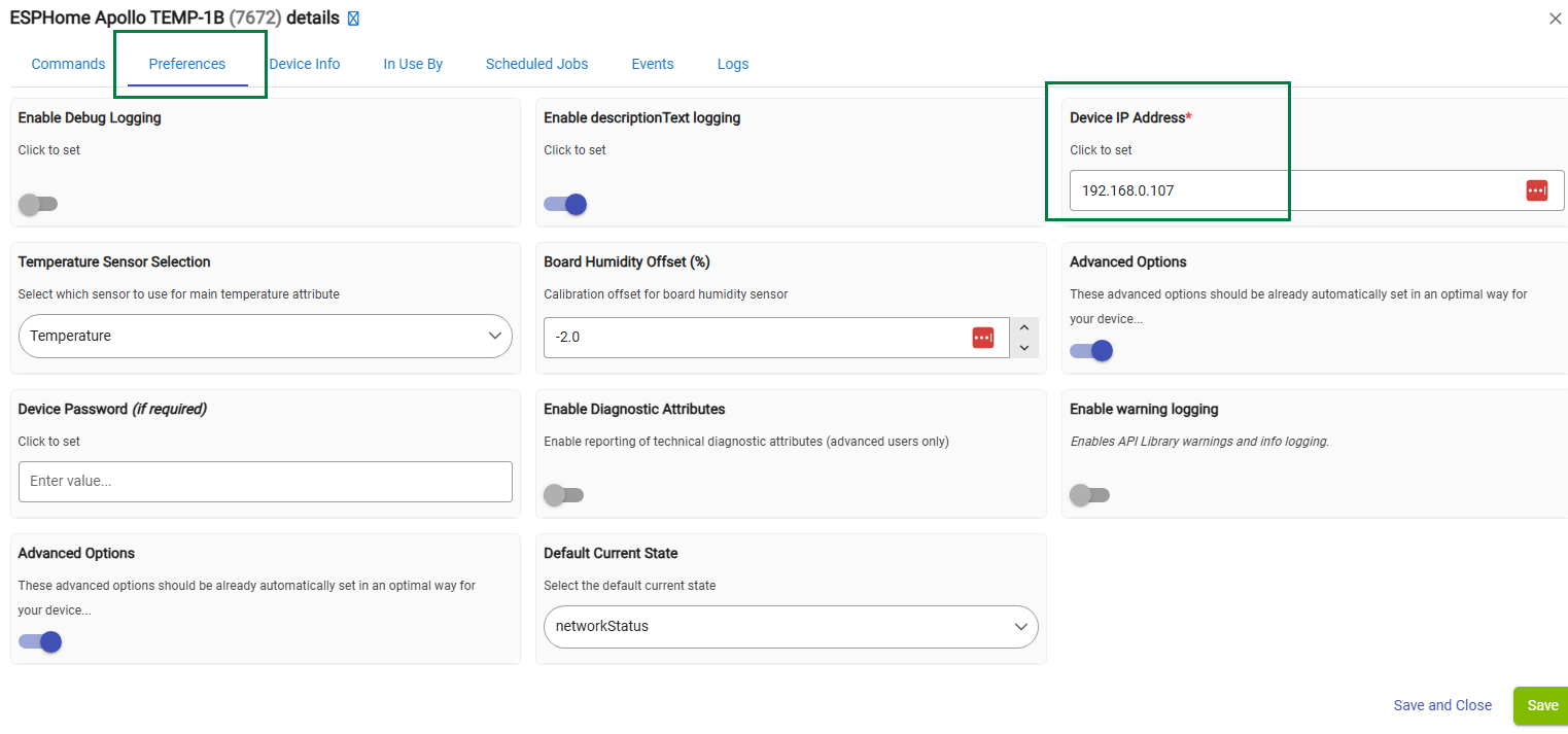

Hate to dredge up an old thread, but felt it was better than starting a new one. I've just gotten my Temp1 and I got it connected to wifi. I used HPM to install the ESPHome Apollo driver. My device logs show that the driver configuration has been updated to 1.0.2 09/28/2025 9:14 AM (C-8 2.4.3.164). But I'm not getting any temp readings and the events show it is constantly connecting and then timing out. Forgive me, I'm not very well versed with this stuff and may be overlooking something completely obvious. Thanks for your help
Have you set the correct local IP address in the Preferences tab?

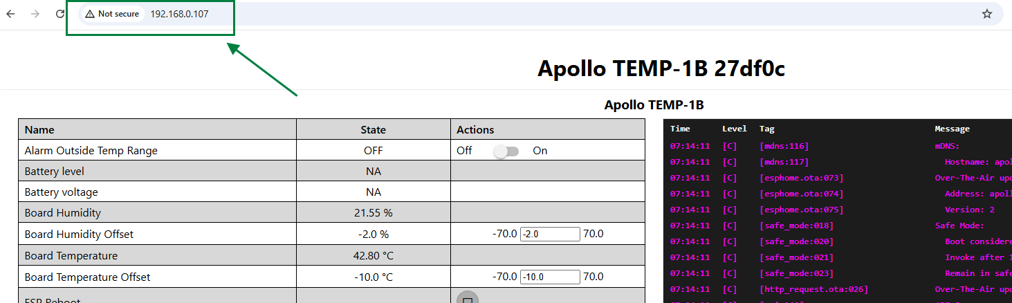

This is mine :
If your TEMP-1 sensor is connected successfuly to your WiFi network, you should be able to open the device web page from a browser :
well I thought I had the IP address in correctly, but I guess not. I wasn't able to log into the device web page like you suggested so I knew it wasn't. I was able to find it in the list of devices on my router and updated and now its working! I just had the wrong IP. Do I need to make a DHCP IP reservation so it doesn't change in the future.
Thank you for your help
Yes, creating a DHCP reservation for the TEMP-1 sensor on your router will ensure the IP address remains the same after device reboots.
