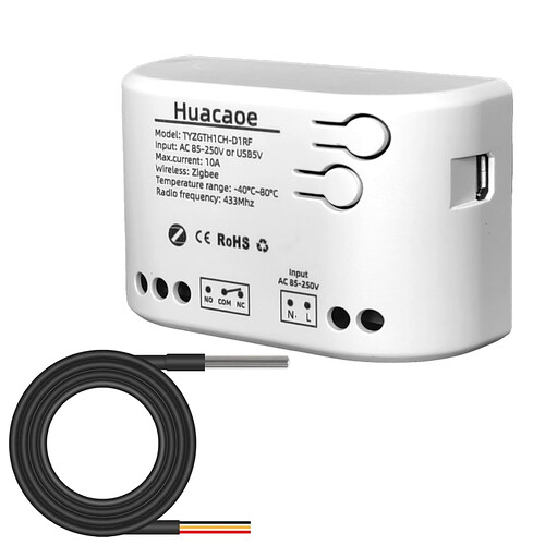

For anyone still trying to get this to work, see the driver code below that I have working to get the temp. Picture below of my unit below too
 *  Tuya TS000F Temperature Relay (Multi-Endpoint EF00 Decoder)
