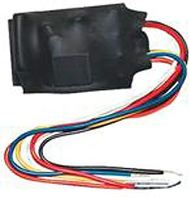

http://www.brkelectronics.com/product/RM4
Tie the relay into any zigbee or zwave contact sensor and your done.

  1. Cost, the relay is less than 20 bucks and the contact sensor can be found cheap as well, you can also choose to go zigbee/zwave/ardino whatever you prefer. Once setup it is good forever.
  2. When it comes time to replace your smoke detectors (10 years typically) you can choose any hard wired smoke detectors you want.
  3. The interconnect relay along with the contact sensor can be installed anywhere you can tie into your interconnect wire. (Mine is in my furnace room, out of sight). Why anyone would want to install the Ecolink Firefighter in a system that has interconnected smoke alarms is beyond me. I guess in some instances it may be difficult to find and tie into the interconnect wire.

Thanks for the link to the BRK relay. I have a house full of BRKs.

The Relay I posted above is made by BRK but it would work on any interconnect wire between smoke alarms. You could use the one made by Kiddie if you prefer:
https://www.amazon.ca/Kidde-SM120X-Interconnect-Accessories-Module/dp/B00HQNPOHI
Yes, I would consider the relay more reliable. It is not an IOT device (just a simple relay) and if it ever failed the interconnect between hard wired smoke/co detectors would still work fine. I would just lose the signal connection to the contact sensor.
