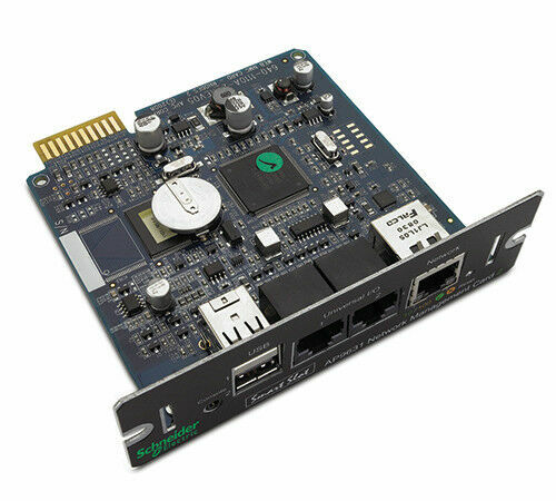

net cards
https://www.ebay.com/itm/APC-9631-Network-Management-Card-UPS-APC9631-640-1110B-Z-Rev-06/133511546132?hash=item1f15e88514:g:LWMAAOSwFn9fUq-t
