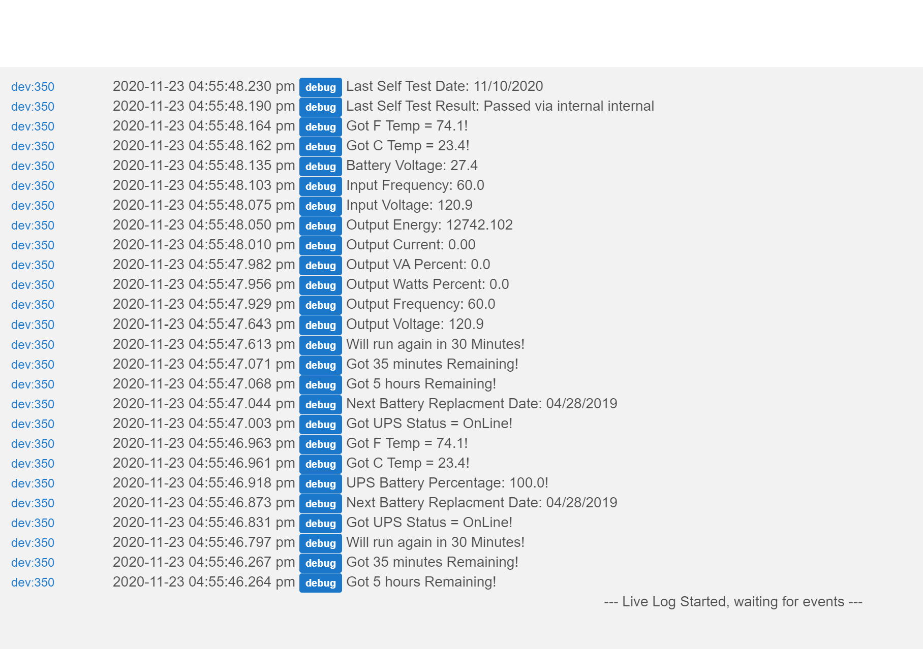

new version 2.0 available via git hub and on Hubuitat package manager..
v 2 added all kinds of new power and battery attributes. Not all UPS cards have all this info, It will report what it can.
As in the past some ups net cards may return different strings than i am queuing off of. If you find this let me know and I fix it.

new version 2.1
added 2 levels of debugging,, off, with only a few lines each run, minimal ... shown above, and maximum which corresponds to old debug.
Also added code to automatically turn off debugging after 30 minutes per hubitat guidlines.
new version 2.2. fixed typo in one of the new attribute names.
