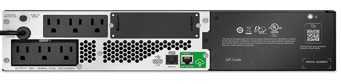

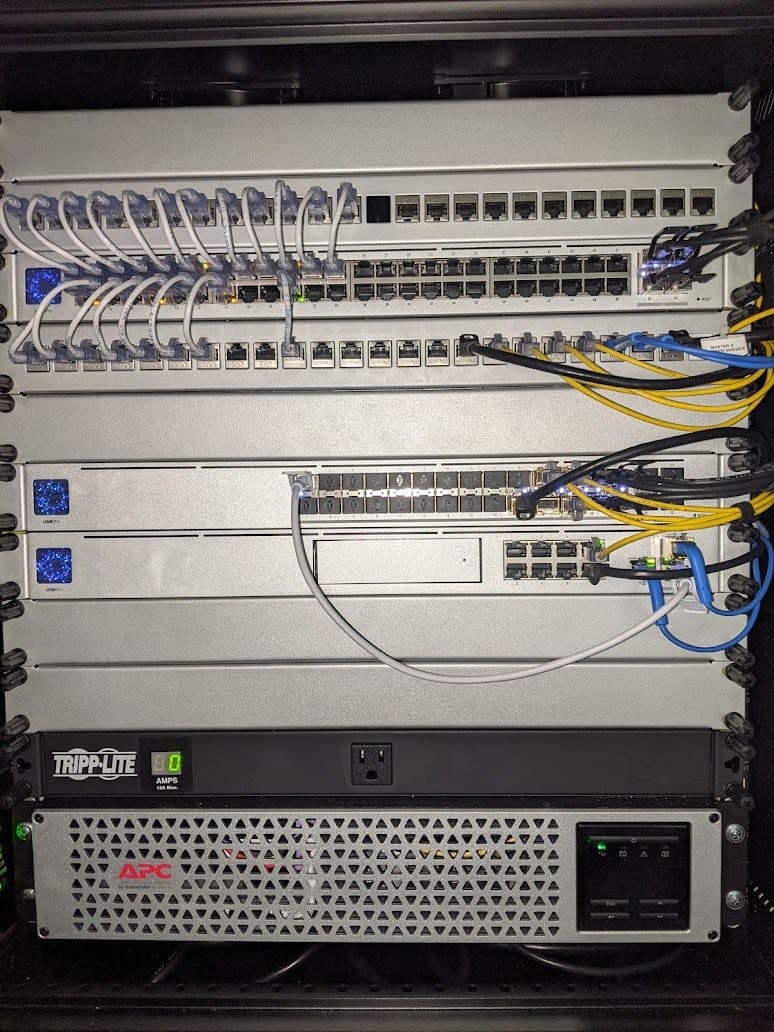

I use the SMTL1000RM2UC. It was pretty expensive around $1500 but it's a Lithium-Ion battery and it has a pretty short mounting depth which was the only way I was going to fit a big UPS in my network rack. The rack only has about 12 inches of mounting depth. All my network gear including an AT&T Modem, Wireless backup modem, Raspberry PI, alarm secondary power source, UDM-Pro, USW-48 Pro, USW-Agg Pro, and all 5 of the AP's are powered off it using PoE and it has about an hour runtime.
For me the SMTL were a better option since I had the rack already. I'd still probably go with the SMTL over the regular SMT's though. The smart connect modules are an addon card that let you connect to the UPS much like a proprietary ethernet adapter.
The card slides into the back where that blank cover is:

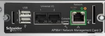

the smt1500 vs smc1500 .. smt1500 older have better runtime
the ones with the c at the end ie smt1500c or smc1500c have the smartconnect card built in so you dont need to buy one..
if i was you the best deal is pick up an older smt1500 and buy yourself batteries so you dont pay shipping for a heavy ups.. and then pick up the net card also separate...
something like this .
the smt1500rm2u are rackmount and take differnt batteries.. not sure where you are seeing them for 100 but they are not that cheap and basically the same price..
this card i picked up one from him for 30 offer.. i have software to upgrade the firmware in it if you need help

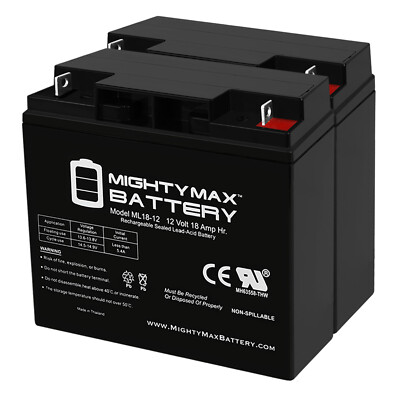

batteries i normally use these

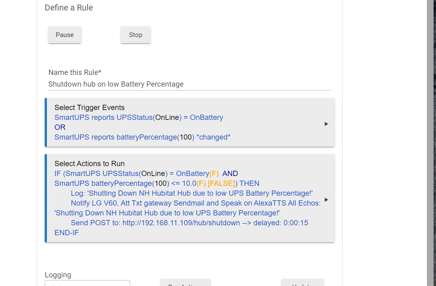

@kahn-hubitat Any way to add Power Source capability to this so that when rule Machine sees UPSStatus as battery it can trigger?
What is the benefit of this as you can already write a rule using the custom attribute to trigger on a power failure.
I guess I was thinking easier not to have to create a local variable to be fed by the attribute and instead just use Power source so RM watched it as the trigger. (easier for newbies I would suppose too)
you dont need any local variables.. see this rule..
you just use a custom attribute (upsStatus) in the trigger like below and check status is on battery
Fair enough... Was thinking of things differently....

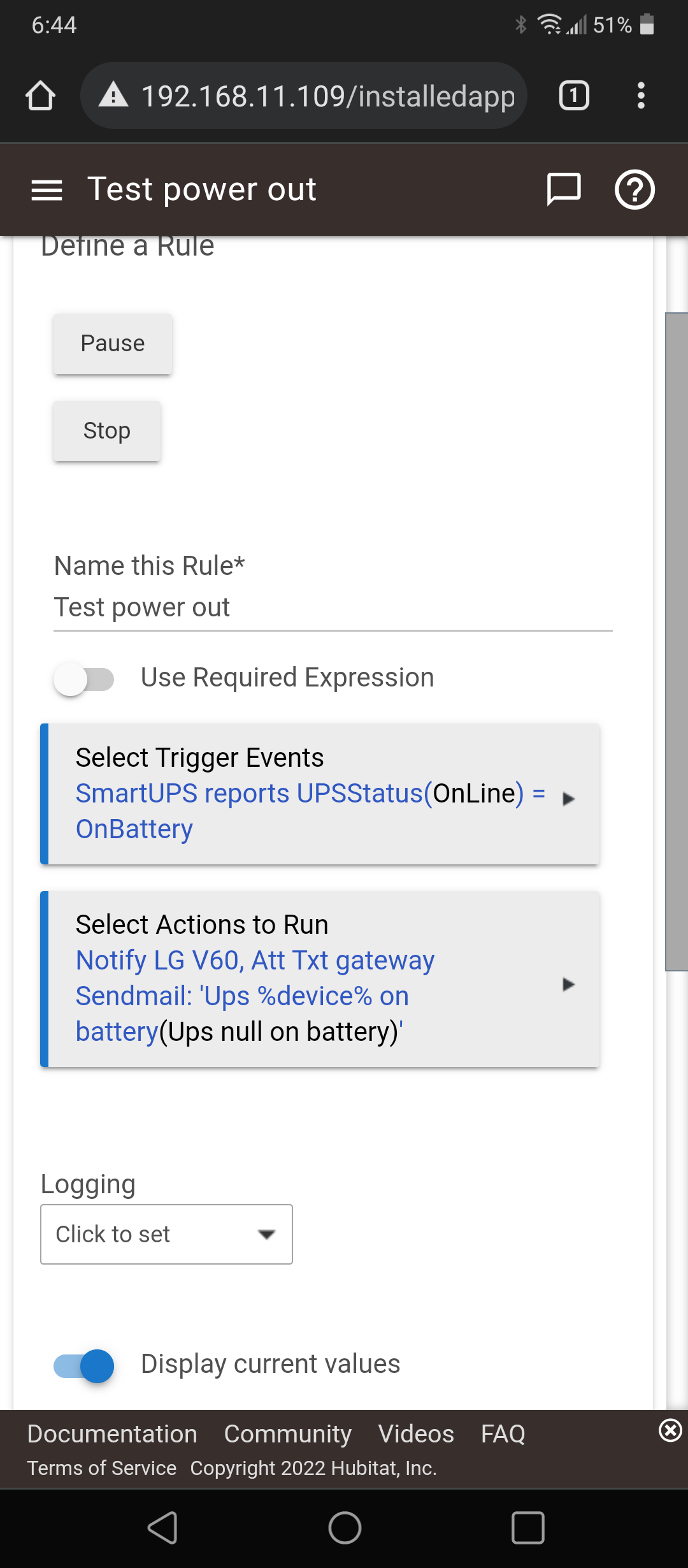

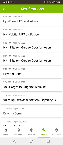

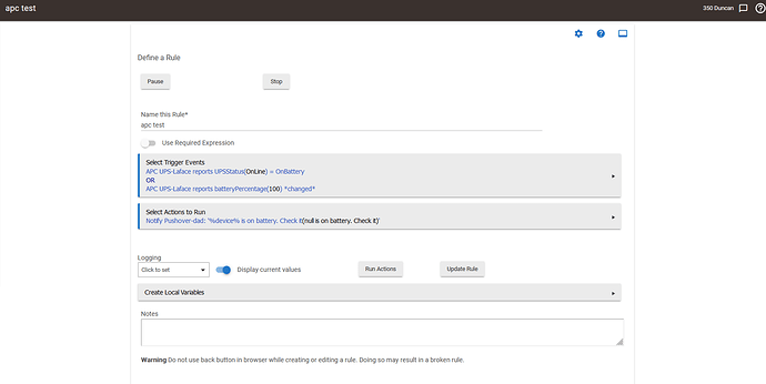

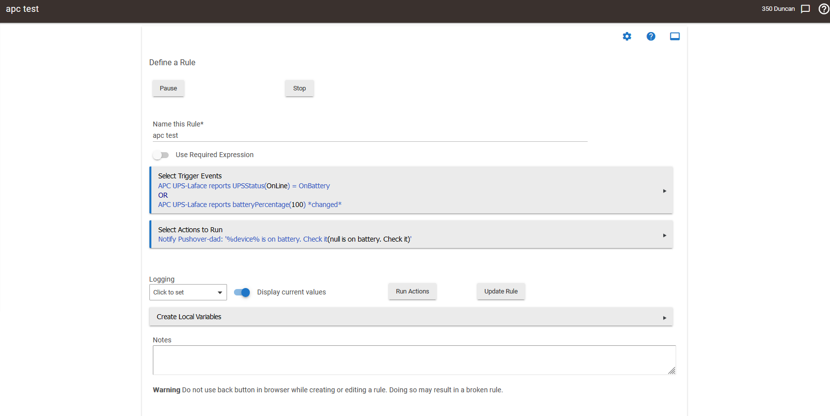

one last thing, is it possible to have the device name attached to the built in %device% variable for notifications? Or am I looking at that wrong too?
That's not something the driver does, i believe it is populated by the system automatically. Someone correct me if i am wrong. Are you saying it is not working?
Yeah. So for instance, in a notification I usually put %device% is doing something, pay attention to it.
%device% is being sent as null
That %device% only populates after the rule triggers, so when you create the rule it will show as null since it does not know what device triggered it yet.
