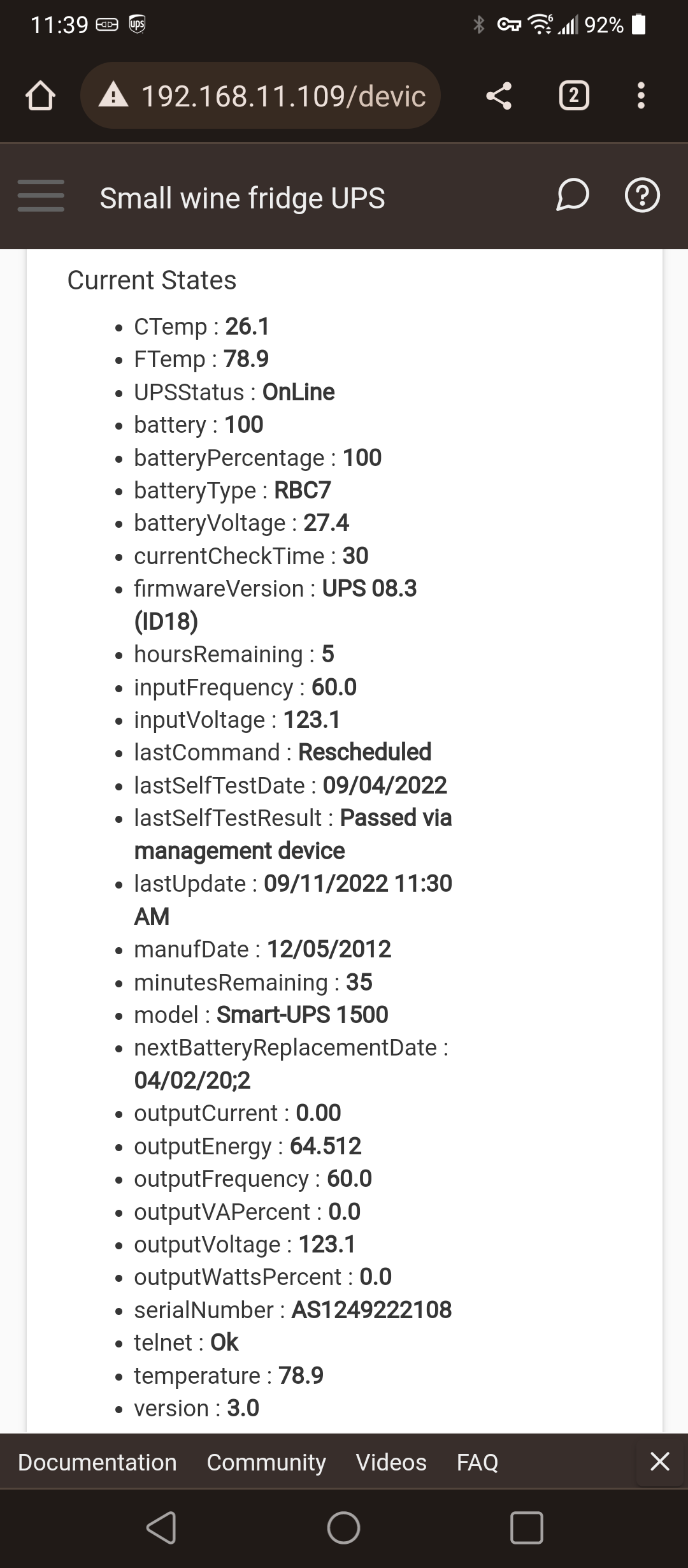

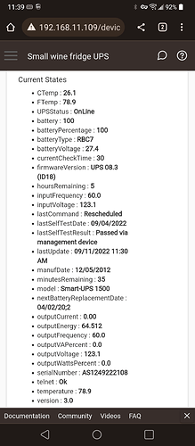

Screenshot 2022-08-18 172439
Seems to work fine, thanks for the driver.

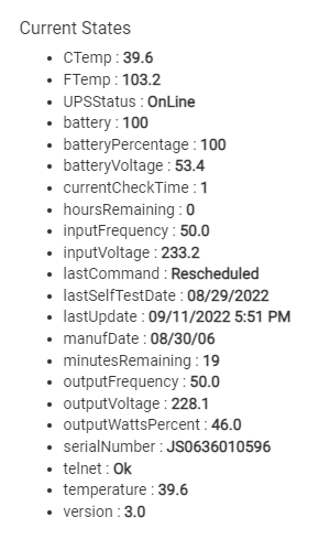

Opera Snapshot_2022-09-11_175125_192.168.1.20
Seems to be working, altough i don't get the new attributes.
You may just need to wait....? For the readings to come through....
You have some of the new attributes
Ie manuf date .serial number etc. To figure out some are missing you will need to turn on debugging and i may need to tweek it for your firmware version.
It looks like only model and battery type are missing.
Also other normal attributes are missing like last My guess is your network card firmware is not fully supported or doesn't have everything. It will be hard to debug Without having one of those cards. What card is it and what firmware version is on it?
Also shouldn't have a current check time as low as 1 minute that can cause undue load on the hub and it may not even finish updating in that time.
Here are all the attributes you should have.

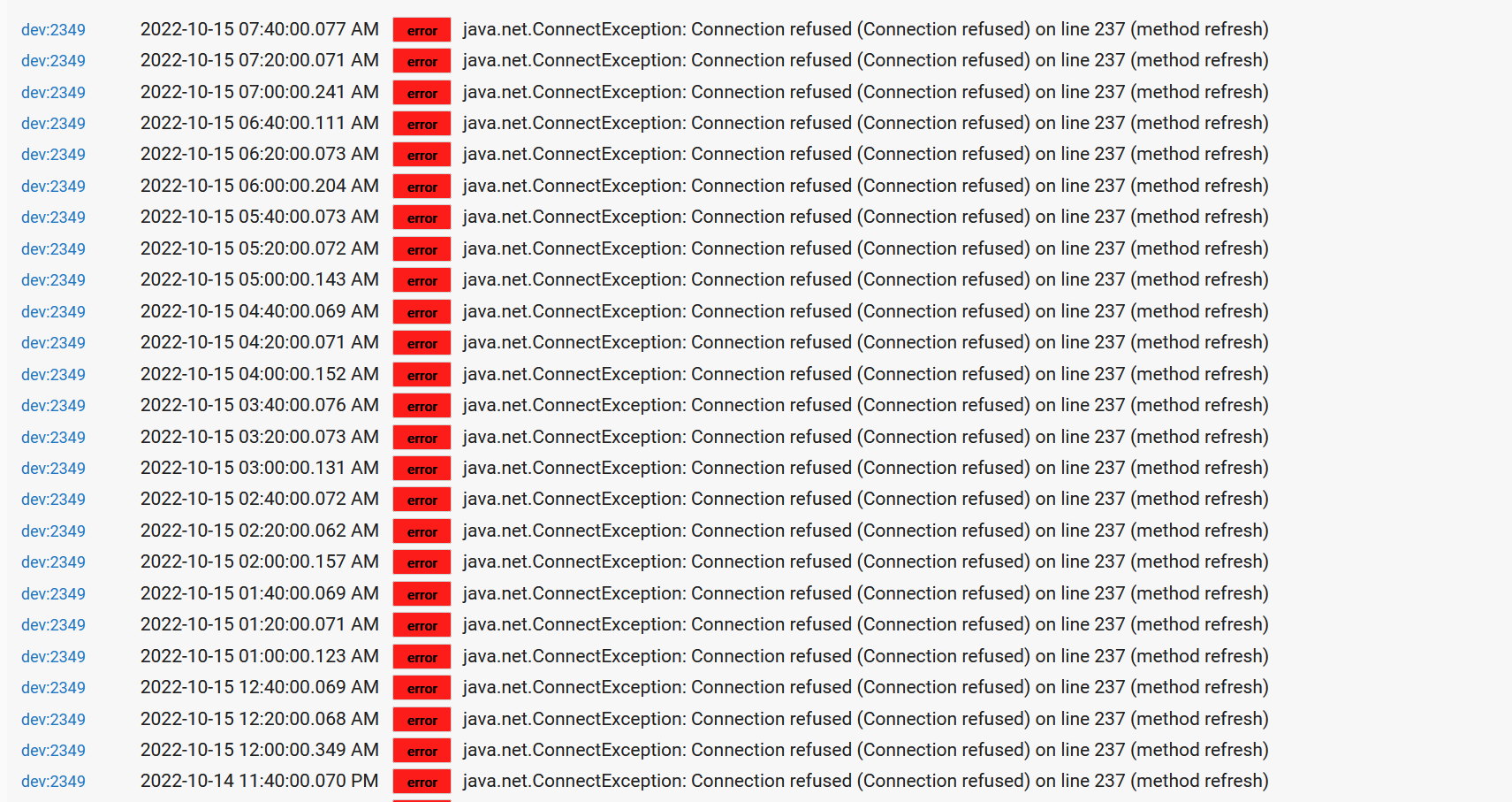

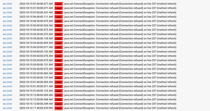

Have a bunch of these in my logs
Try manually telneting from a command prompt.
. That usually means the ip address changed or the ups is not online or user/
Password is not working.
No problem, username and pw check out fine
Check ip address in driver . Is it the same.

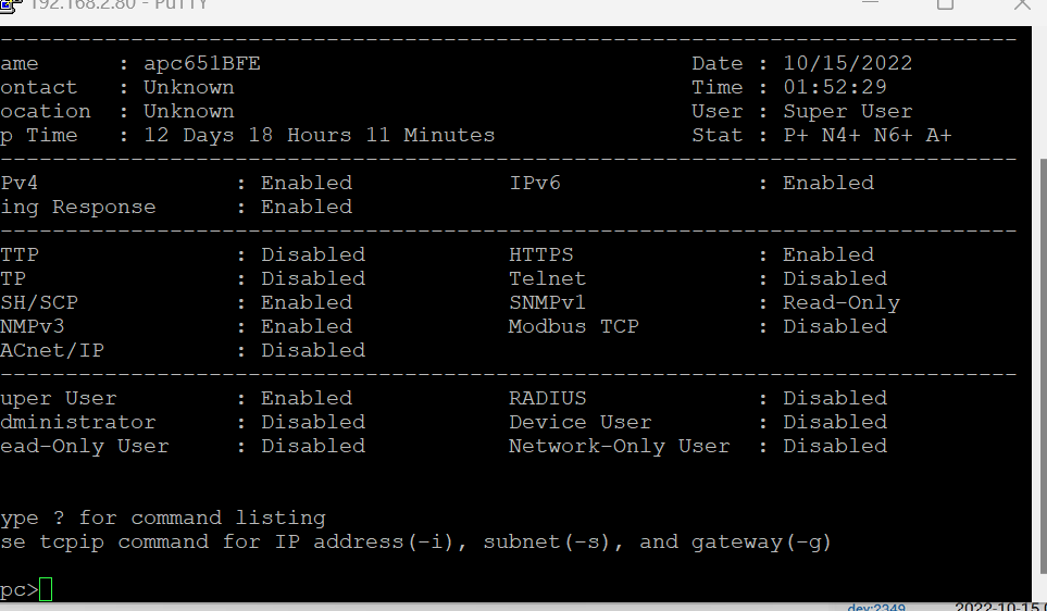

How are you getting that outout?
Right inside it shows telnet disabled.
Must be using ssh?
Enable telnet in the net card
