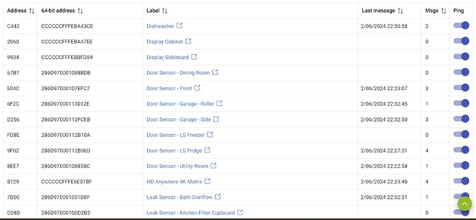

My C8 Pro had been functioning fine until this evening, when a number of Smartthings outlets, motion sensors and multi purpose sensors stopped responding on the Zigbee mesh. Under the Zigbee details menu, the "Last message" fields are blank on all the affected devices. I've done a reset with database rebuild which didn't fix it. Any idea's what's going on and how to get it back up and running?

Just completed the reboot, got even more blanks in the Last message table now

Went round unplugging repeater outlets and removing batteries from all 26 failed devices which brought them back up. Any ideas why this happened?
