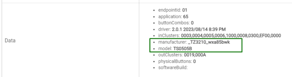

So I got a Tuya ZigBee 3.0 Leakage Alarm Detector Water Leak Sensor installed on my Hubitat C8 Pro but I can not get any response from it with the probe in/out of the water. I have excluded it and included it multiple times as well as trying several generic drivers as well as the Tuya Zigbee Tank Level Monitor. No response from the device under any circumstances. Maybe a$1.41 price tag wasnt that good a deal :smirking_face:
The cheap ZigBee devices can be a PITA. :wink:
Start with trying DLV.
And this THREAD is helpful to find what exact device you're dealing with.
Good luck!
See also Modified DLV, particularly good for Tuya devices:
Well I give up. I tried so many different options even beyond those suggested here. I even included it onto another C8 (not pro) aqnd the results were the same. No problem adding it , it just doesnt respond to anything. :roll_eyes: Sigh, that $1.41 I’ll never see again. :grinning_face:
I assume you have one of these, using AAA batteries:
I would try the Modified DLV method ( see Water Level Detector - #13 by John_Land), making certain to do the “remove batteries” step. I’d also try from scratch, deleting the prior versions, pairing once using Modified DLV, then pairing again (Modified DLV can be used here) without removing the initially paired device. Also, does the LED of the device blink at all when you put it into pairing mode?
What? That's not allowed. :grinning_face_with_smiling_eyes:
If you change your mind have a look at this thread:
Search the thread for the Manufacturer/model from your Devices Data section for any matches or possible solutions.
Like this:
Not likely, but it might be as simple as installing the Dev Branch Driver. :thinking:
When changing drivers, always re-pair your battery-powered Zigbee sensor with your C8 hub (without deleting the device).
