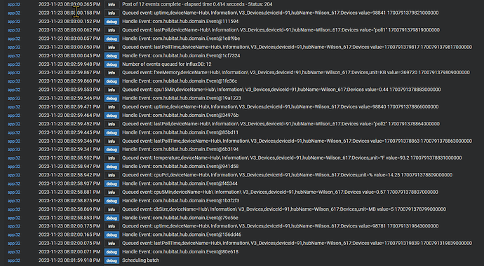

If you look at live logging do you see any errors for InfluxDB.

To me this looks like you aren't getting data into InfluxDB for some reason. Can you pull up your live logging and filter on the InfluxDB app name so we can see what it is showing.
You could also temporarily set the InfluxDB install to debug logging. It is somewhat limited in it's default install setting. By setting it to debug you can see the whole flow of what is happening. Though if it is outright failing that should show up anywhay.

I have also again temporarily reduced the backlog limit, as well as turned on debug logging.

Based on the oldest log it does appear you at some point had a failure writing to InfluxDB that was resolved. That is good we got that working and that is likely the cause of of it not showing up.
