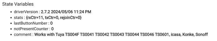

Additionally, I noticed this:
Shouldn't it say TS0043? I can't seem to find a way to change this like in some of your other drivers that offer a picklist.

No, 'Tuya Scene Switch TS004F' is the driver's name, and it doesn't change regardless of the device model.
But probably you meant that the 'Device Name' is not set automatically to 'Tuya Scene Switch TS004F' ? On your screenshot, the device name is set automatically by HE to 'Device', which usually means that this custom driver was not automatically picked up during the first pairing.

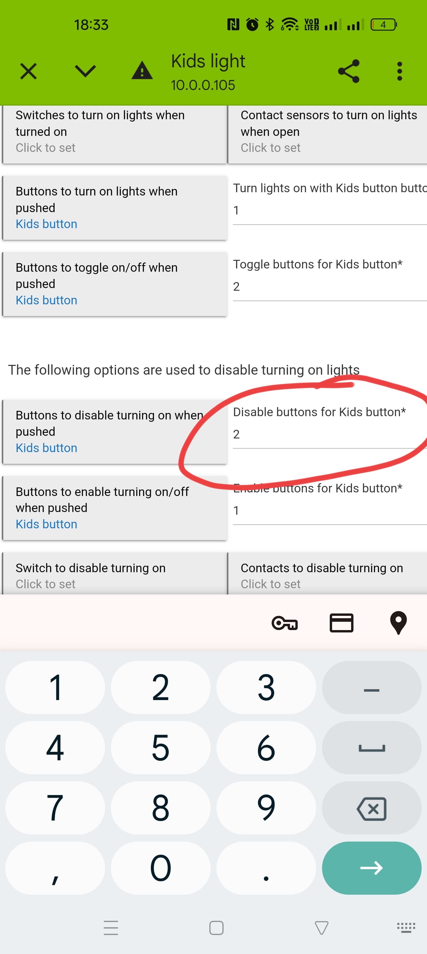

I also wanted to add a button to the "disable button". Is it poasible to add another button number or i can only insert one button per field?
If so, i will just have to set another rule but i wanted to ask if there is a shortcut.
Thanks,
It seems like the Room Lighting app allows to specify only one button per device at the '...disable turning one when pushed.' settings.
A possible workaround could be to create a virtual button and then use the HE Mirror app. Or, if the Mirror app does not work - use RM5 to simulate a button 'pressed' event of the virtual button, when the real device button was pressed.
