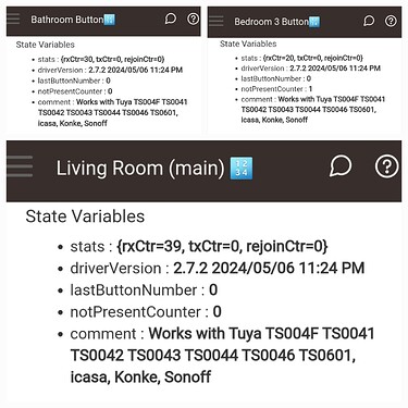

Actually, I did notice high connectivity issues.
Summary - apart from bedroom 3, I have experienced missed activation with the buttons in the screenshot below
It is difficult to say whether the number of the Zigbee network rejoin events is too high or is normal...
This driver is missing a command to reset the statistics, it may be a good idea to add such a function. Probably when the 'Configure' button is clicked.
Yes, true - a reset stat function will be useful.
These button controllers have been working fine since the last battery change, so not sure when the rejoin events occurred.
My Zigbee network

Dev. branch version 2.7.2 2024/05/06 12:49 PM clears the statistics when the Configure button is pressed. (the driver version is refreshed in the State Variables when something is received form the device, and the browser page is refreshed).
@iEnam I think that I may have found the problem - it may be a 2-years old bug... : (
Update to the new dev. branch version, 2.7.2 2024-05-06 timeStamp '2024/05/06 11:24 PM'
  • bug fix: TS0044 _TZ3000_vp6clf9d _TZ3000_ur5fpg7p _TZ3000_wkai4ga5 needed to be pushed twice to activate a button;
  • Configure button will reset the statistics;
Only these 3 TS0044 device manufacturers are affected, this explains why I can not replicate it with my devices.
Please test and let me know if the problem with the missing event has gone.

  • driverVersion : 2.7.2 2024/05/06 11:24 PM
  • stats : {rxCtr=22, txCtr=0, rejoinCtr=0}
  • lastButtonNumber : 0
  • notPresentCounter : 0
  • comment : Works with Tuya TS004F TS0041 TS0042 TS0043 TS0044 TS0046 TS0601, icasa, Konke, Sonoff
