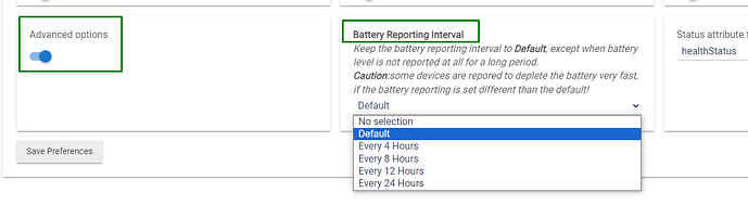

There is an 'Advanced Option' that you can experiment with :

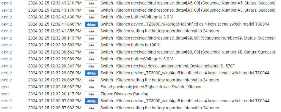

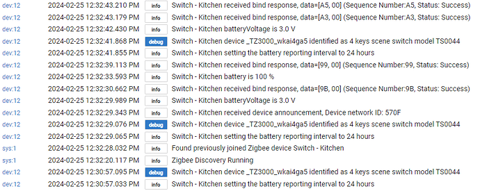

By default, this driver does not configure explicitly the battery reporting time, because some weird devices don't like it and will deplete the battery in no time.. I don't know how your device will react, it may be a good idea to try with one of the scene switches only.
You must change the reporting period to one of the options different than 'Default' and Save the preferences. Nothing will happen at this time - you must pair the scene switch again to the hub (without deleting it). During the pairing process, the battery reporting configuration will be sent to the device. This is the only time when it accepts the configuration changes.

I and changed all ( 5 ) of them to 24hrs. :frowning:
They all report battery now .. but every 15-17 minutes ! LOL ( Not Good )
Weirder, they now "flash all lights" when it sends the battery info ! ( that's very bad )
killed about 10% - 20% battery in just a few hours .. Anyway ..

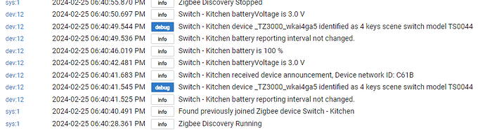

I tried to set them back to default in the driver ..
But the logs always said : battery reporting interval not changed.
I tried a bunch of times different ways / things .. always got the same thing.
Even tried 4-8 - 12 hours to see what happened .. same thing :frowning:

Your devices are exactly the problematic type where that doesn't like battery configuration. The known negative effect is exactly as you describe it - "flash all lights" and killing battery.
The lights are flashing, because the device is restarting and leaving the Zigbee network, then joining again. This kills the batteries.
Keep the 'Default' battery reporting configuration for TZ3000_wkai4ga5. Before re-pairing to the HE hub, perform the same 'reset to factory defaults' procedure - remove the battery for 20-30 seconds, press buttons to drain any remaining voltage/energy in the controller, put the battery back and pair it again.

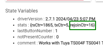

Observe the 'rejoinCtr' in the state variables : if the number increases, this means a problem - the device is rejoining the HE network and the batteries will deplete in no time..

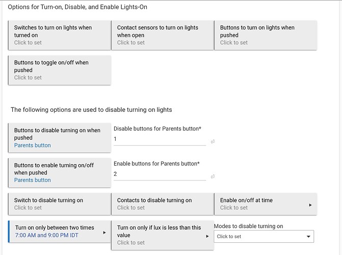

I'm trying to make in work with Motion and Mode Lightning app but i can't get it to work.
I have an automation that when entering the room, the lights turn on and when no motion is detected, the turn off.
I want have the option of enabling and disabling the automation, but i cant get it to work.
At the moment only the disable button work and i also tried switching the 1 and 2 numbers.
And ideas?

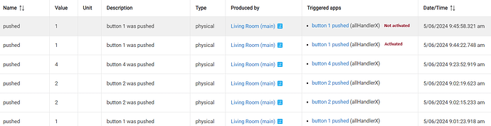

Seems to be a "debouncing" issue.
Logs
dev:7462024-05-06 09:46:27.390 AMdebugLiving Room (main) :1234: debouncing timer for button 1 expired.
dev:7462024-05-06 09:46:26.391 AMdebugLiving Room (main) :1234: restarted debouncing timer 1000ms for button 1 (lastButtonNumber=1)
dev:7462024-05-06 09:46:26.380 AMwarnLiving Room (main) :1234: ignored event for button 1 - still in the debouncing time period!

This Info log is sent together with a button 'pushed' event - you can check in the Events history tab...
The debouncing algorithm is activated, and approx. 950 milliseconds later a second 'pushed' event received from the remote is ignored correctly.
For me, the logs above show a correct behavior.
A possible reason for the first button press to be lost is if the remote has lost the connection to the Zigbee network... So with the first press of the button it wakes up and re-joins the network.
Look at the 'rejoinCtr' - an unusual high value means connectivity issues..
Strange, see events log below.
When button 1 was last pressed (just over a minute from last activation), the living room light did not turn ON.
