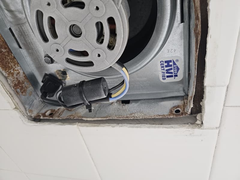

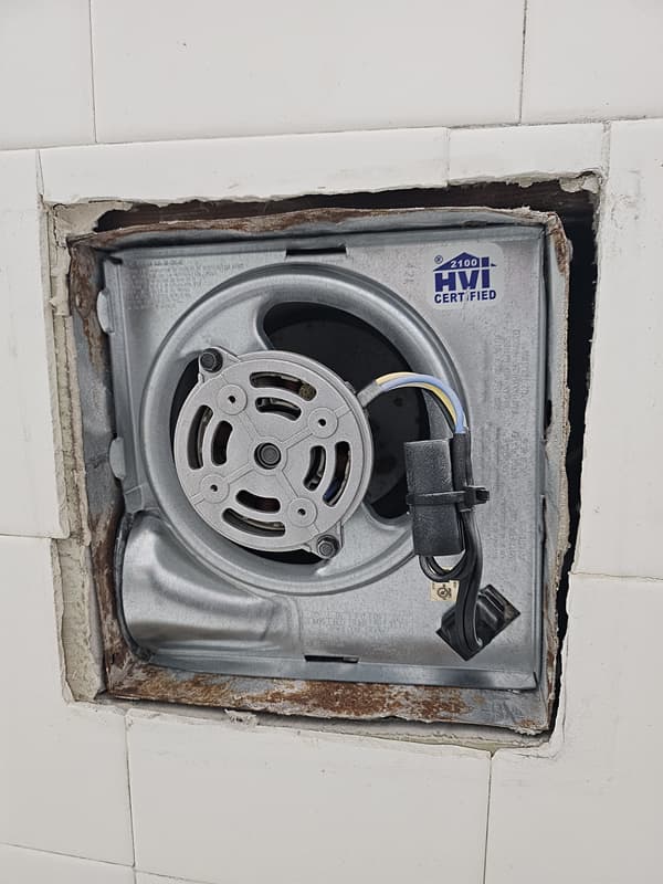

So I have an interesting issue and thought that HE could solve it perfectly - if I can find the correct hardware. Ultimately I think I need a very small footprint smart plug or one that is angled 90 degrees.
My single light switch in the bathroom controls both the light and the exhaust fan above the shower. The fan has a hard time with the amount of "on time" it has (and the bathroom light has to stay on for safety reasons). The way the fan gets power is a 2 plug prong in the box it's mounted in and so I thought a smart plug in the middle could provide a way to solve this - and I could use a water sensor in the shower, a motion detector, a humidity sensor, or even just a button to turn that plug on and off, thereby separating the light from the fan. The problem of course is that I need to find hardware that physically fits in the box.
Here's some pics:

It looks like that fan is within a mounting box/duct, and it can possibly be separated from the box after unplugging it, giving you access to that outlet from behind the fan, which may open up other possibilities.
That little plug is more of a convenience allowing the fan to be removed. The real story is what is going on in the junction box above that fan where you will find the neutral wire you need for a dry contact relay. I have used a Zen51 for just such a thing but that is z-wave. A google search showed a lot of small Zigbee dry contact relays which I think would do the job for you.
it's a fair point, but getting behind the box without removing tiles is proving hard to do. I ordered SONOFF ZBMINIL2 Extreme Zigbee Smart Light Switch (2 Way), Works with Alexa, SmartThings Hub, Google Home&SONOFF ZBBridge-P, ZigBee Hub Required, No Neutral Required - Amazon.com and I will see if I can cut into the wire and use that to control the fan.

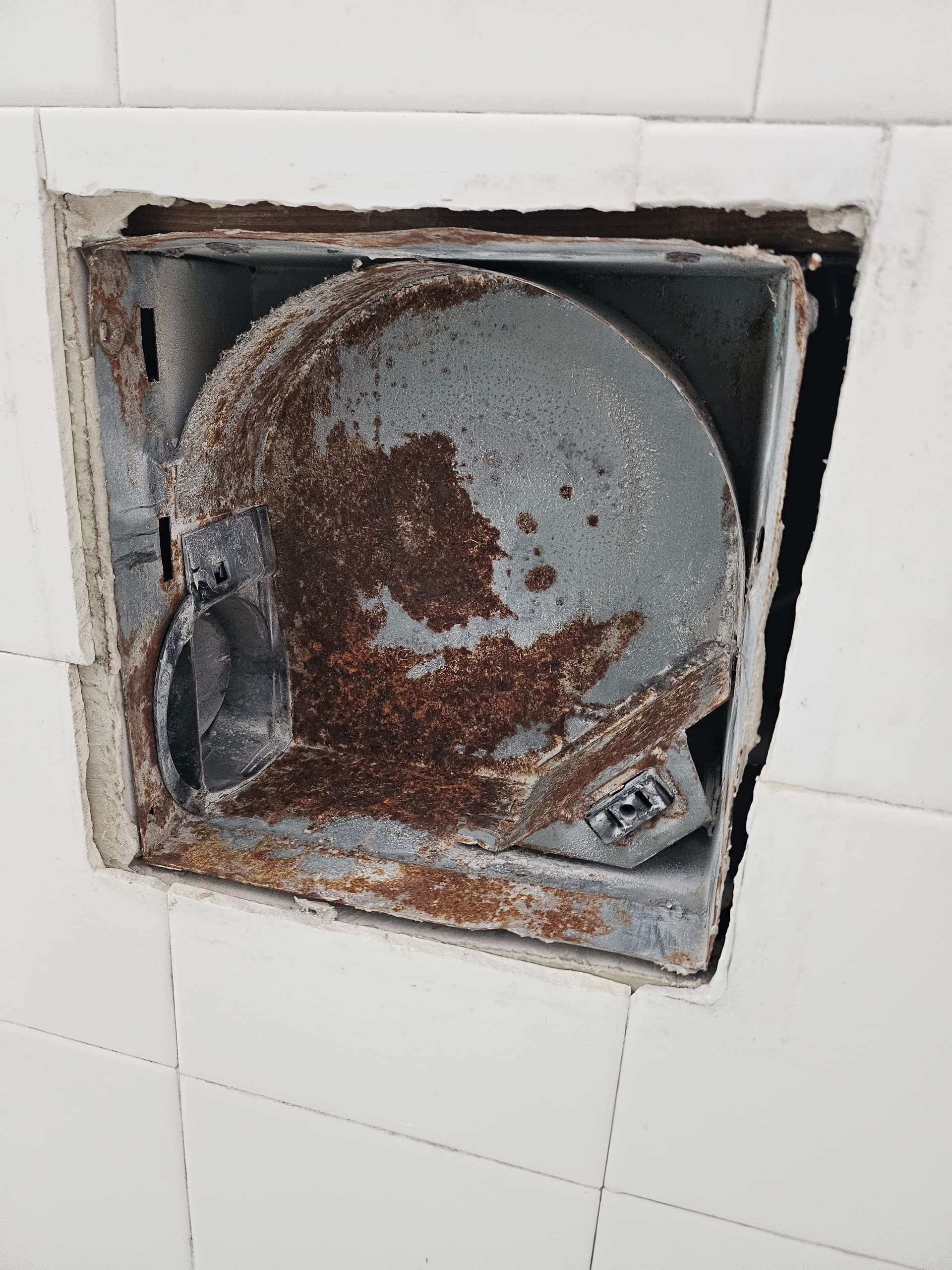

Can you remove the fan itself and see what’s in there?
Not sure you would need to “get behind” the box, maybe just inside it?
I wish it was setup like that....

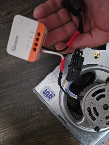

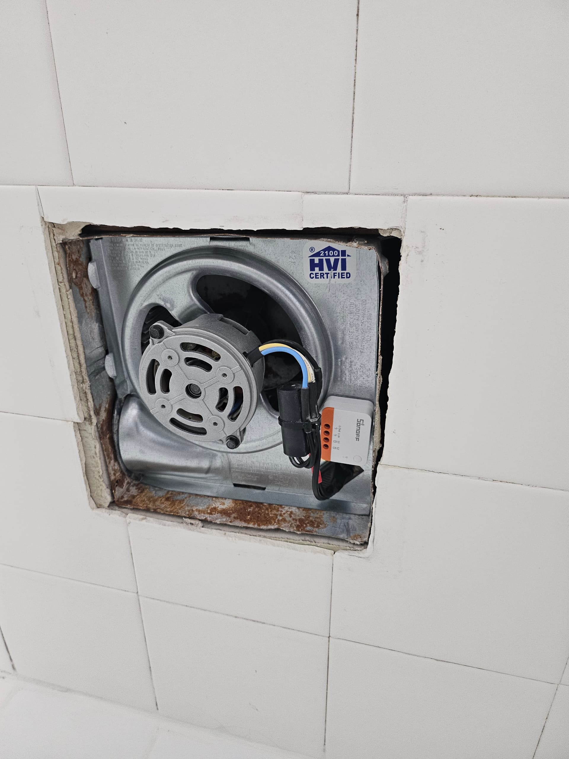

My final solution is the following relay switch, that I placed inline.
I know you said the light is always on then so is the sonoff. Switching off the light also switches off the sonoff (and the fan) is there a delay in power being restored to the sonoff and being able to command it? If there is and you know how long you can incorporate it into any rule you make for it.
That's hard for me to know. If I turn off the light, the fan goes off right away. If I turn it back on 10 seconds later, the fan turns back on automatically. The green light on the relay never shuts down. If I wait a few* hours and then turn it back on, the green light on the relay is off, the fan does not turn on until I tell the relay to turn on, and my testing is that it connects right away.
I suspect the relay has some sort of capacitor in it for the zigbee radio and that it does not "shut down" right away.
Note that I spliced it in on the hot wire (tested beforehand).
