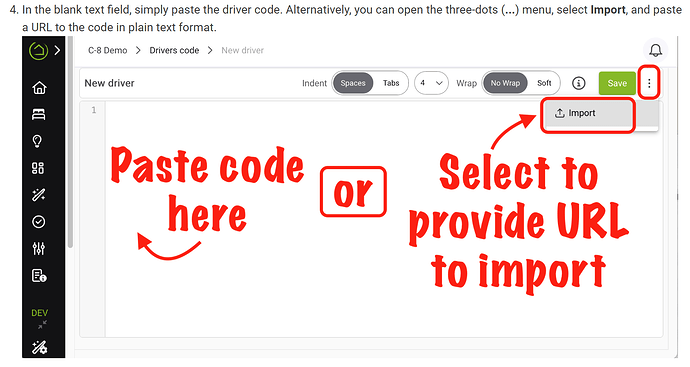

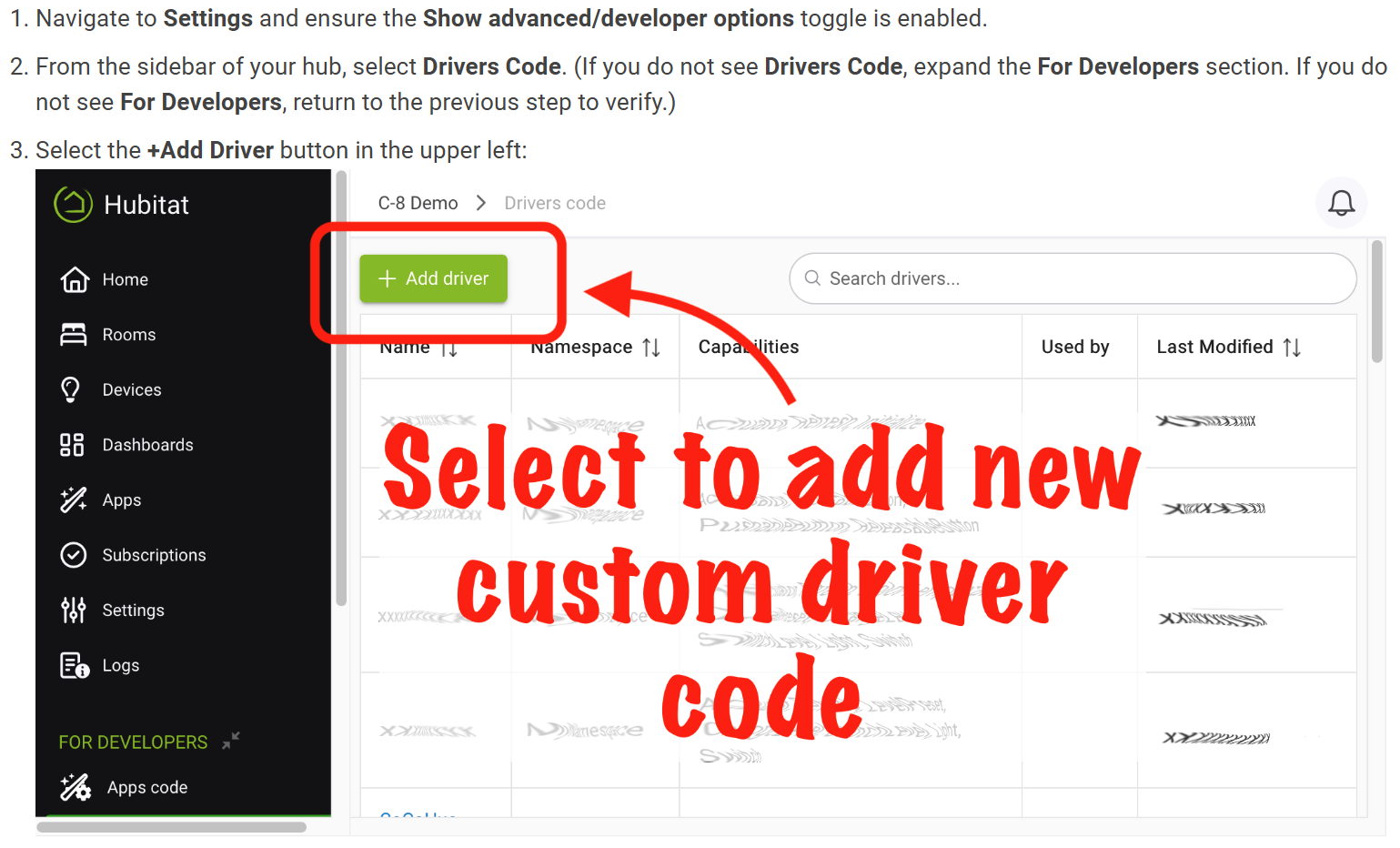

But for a single component driver it's sometimes just as quick to do a manual Import/Save.
  1. Right click on this Raw Link, select Copy Link Address.
  2. In the Hubitat GUI click on Add Driver
Add Driver

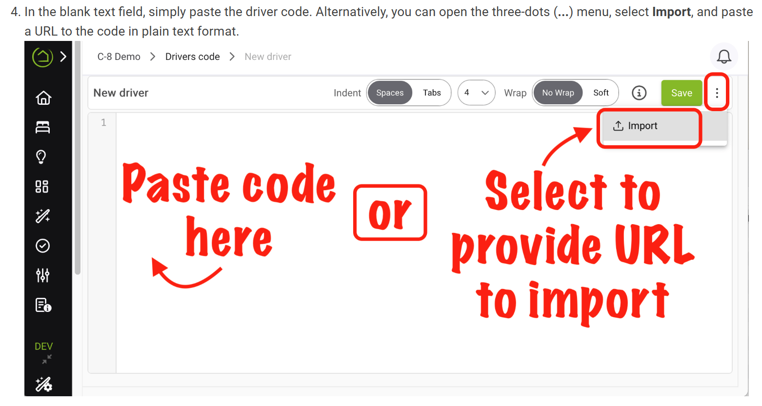

  1. Click on Import
Import
3a. Paste the copied address link in the input field, click Import button.

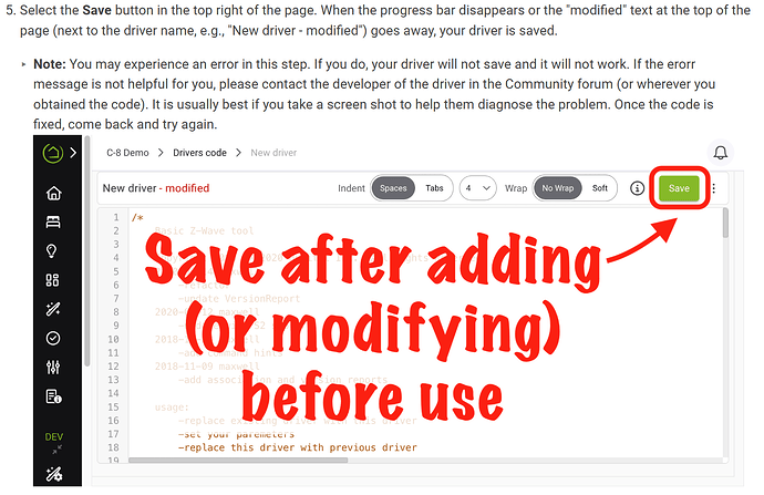

  1. Click on Save
Save
Refresh the ZigBee Relay Device Info page, select your new Tuya Zigbee Switch Type (aka driver).
