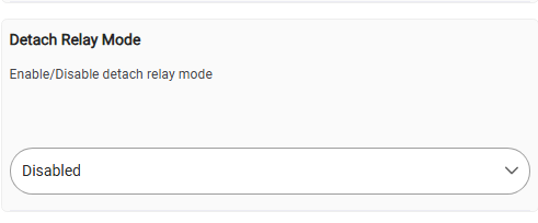

I googled ZBMINIR2 quickly, and it turns out that this device also supports a detached relay mode!
That's very interesting, I will look deeper into it during the incoming holidays when I will have more time.

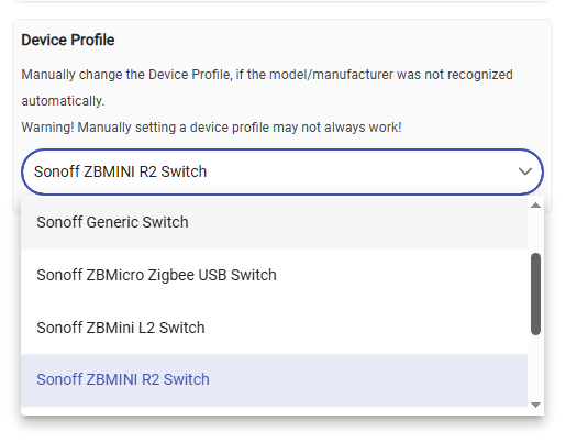

As ZBMINIR2 fingerprint is currently not in this custom driver, it is normal to show ' * deviceProfile : UNKNOWN'.
The Status: message should also change to 'clear' after a minute.
Hi. After a few minutes this message went off and now I can observe:

Enable the 'Advanced Options' and click 'Save'.
Then, from the 'Device Profile' dropdown list select 'Sonoff ZBMini L2 Switch'. Although your device is a newer model, I suppose this profile will work for it as well :
Will the switch on/off status be updated automatically now?
I did it. So it generally works but I could observe that devices are not sending feedback to system after switched by physical switch (btw on R you can setup many types of switches, really nice).
However after certain time it started to work and now it send's feedbacks to the system. I will observe.

Hi @eduardo ,
I have added a dedicated 'SWITCH_SONOFF_ZBMINIR2' profile in the new 'Tuya Zigbee Switch' driver version '3.3.0' '2025/03/09 10:09 PM' . Update manually : https://raw.githubusercontent.com/kkossev/Hubitat/development/Drivers/Tuya%20Zigbee%20Switch/Tuya_Zigbee_Switch_lib_included.groovy
I don't have the R2 switch, so we may need several itterations until it works as expected.
Click on the Configure button with 'LOAD ALL DEFAULTS' option. This should also configure the device properly.
Please test also the 'Network Indicator' option - does it control the LED ?
Just for a test, enable the 'Advanced Options', only then you should see the 'Detached Relay Mode' option
For a test, set it enabled - what will happen? :thinking:
I will need the debug logs that follow pressing the physical switch of the R2 in detached mode. The relay should not switch on/off in detached mode, but the device must send some zigbee messages in the debug logs (I expect to be the OnOff cluster 'toggle' command)
I have done that, it selected the correct profile. Before that I've cleared current states and state variables.

Detached Relay Mode
I couldn't turn on this mode, after enabling and saving, if I refresh the page, it is back to disabled.

Yes, the preferences should show up in the Current States in this driver, but only when successfully reported back from the device. In the previous version the parameters data types were wrong, hopefully in this update we will have some progress.
Update again - same 3.3.0 version, but the TimeStamp is '2025/03/09 11:59 PM'
Tested again with the new version.
Turbo mode goes back to disabled after enabling and saving, but it now shows on the Current States.
Detached Relay Mode is on Current States but still pressing the physical button turns on an off. Maybe it works just with a switch connected to S1-S2?!
Network Indicator is not on Current Sates, the LED is always on.
