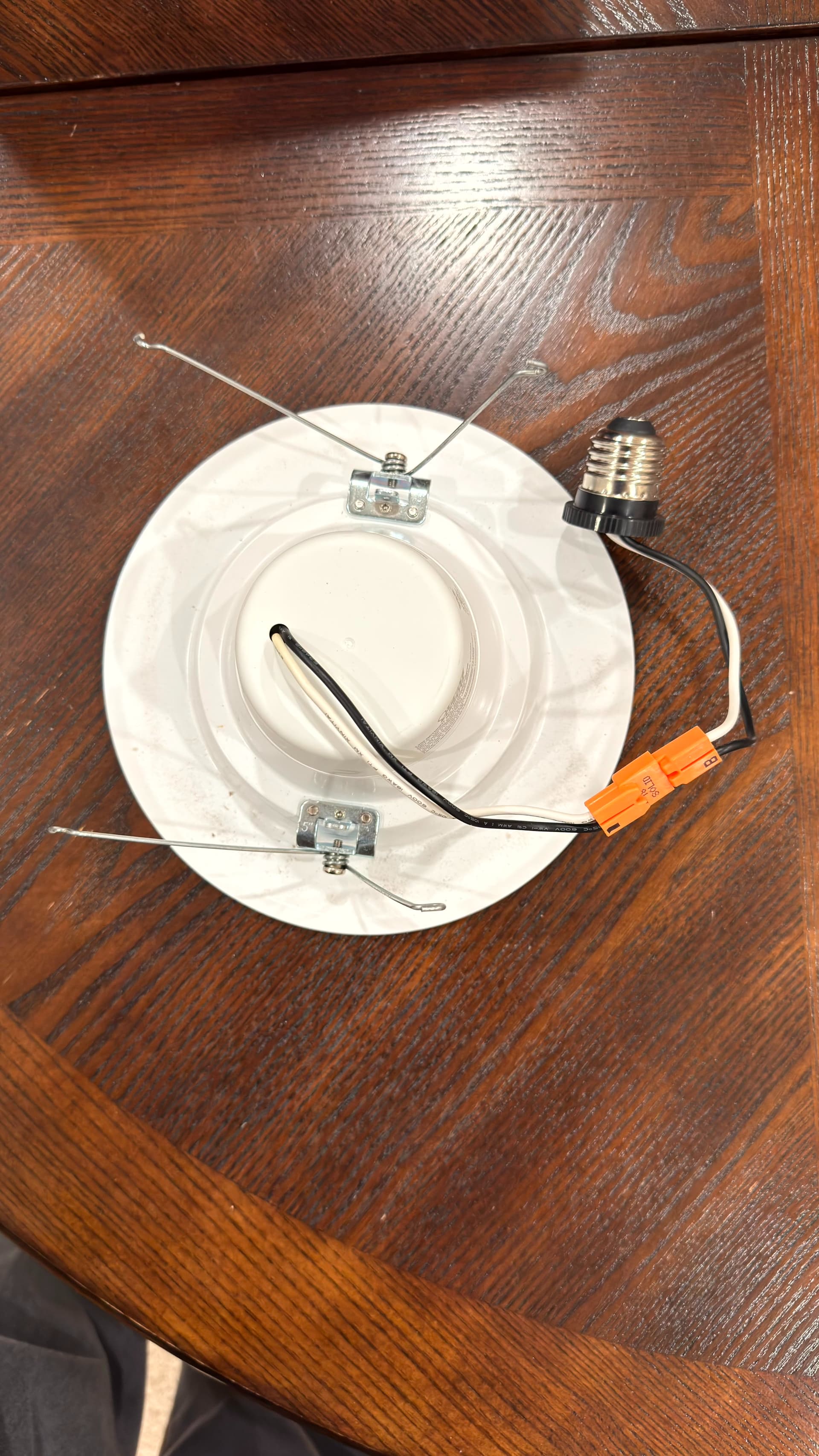

Original wiring

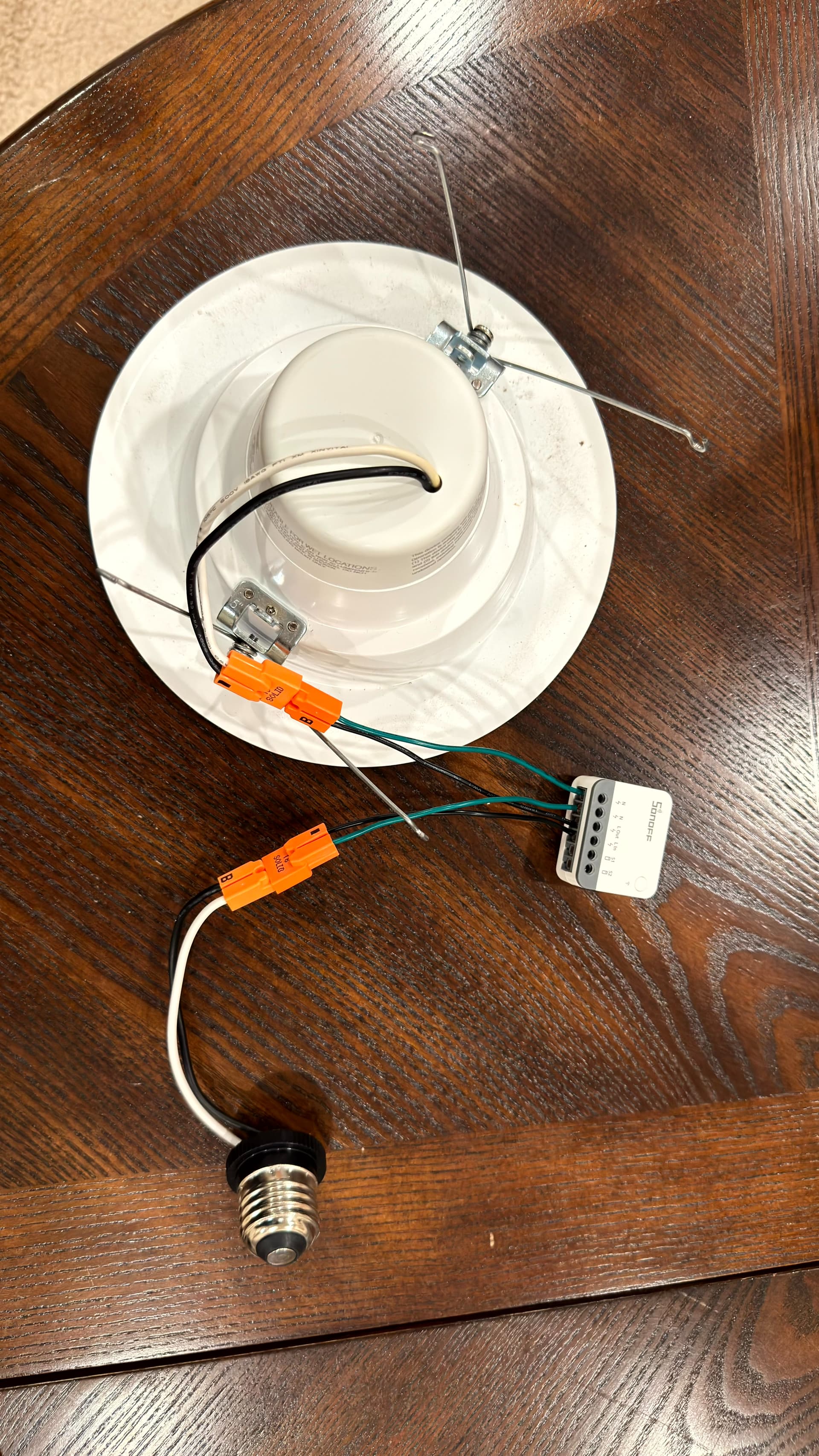

With the Sonoff wired in between.

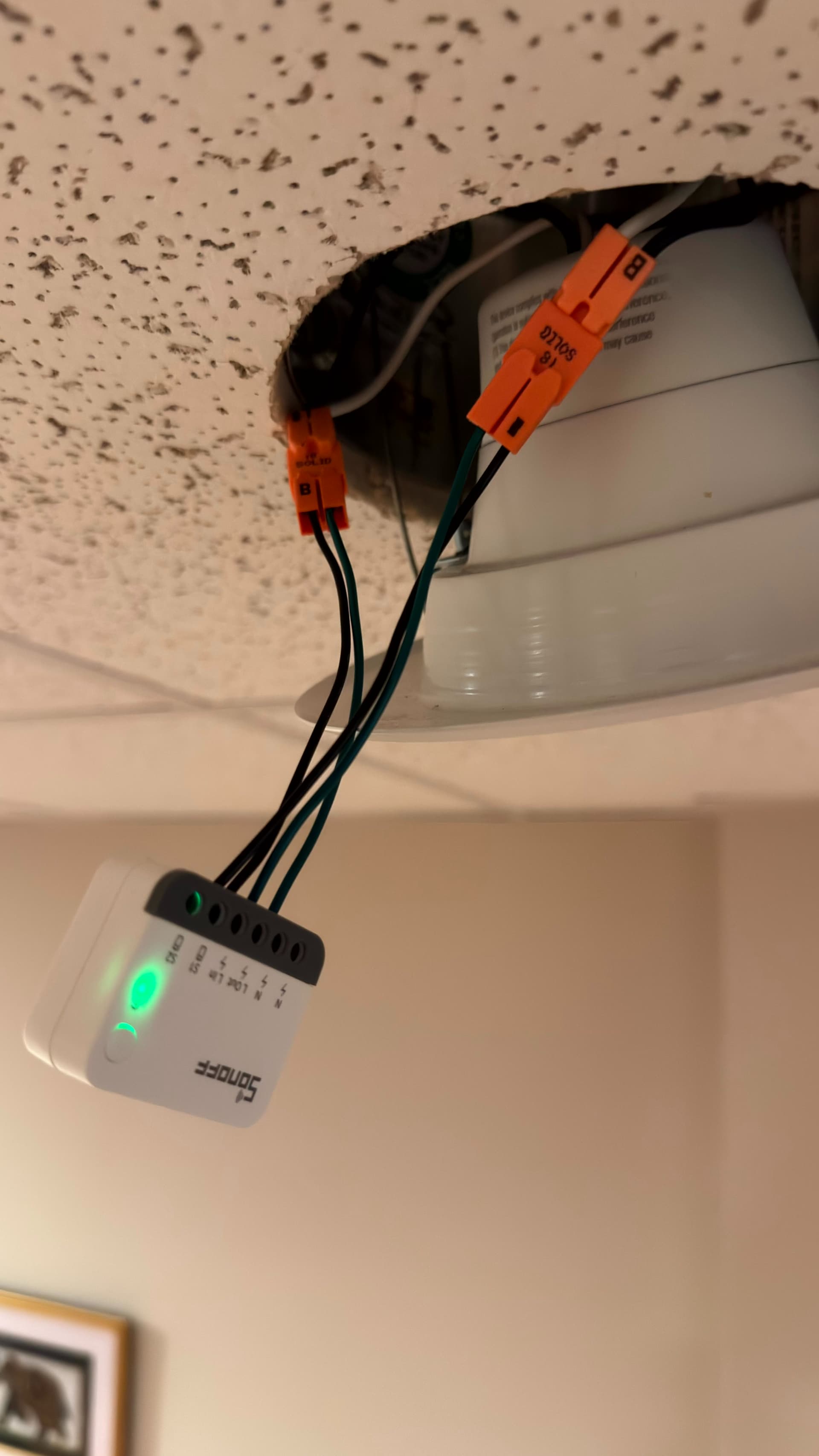

Installed and working, before being hidden in the can.
The pictures don't show it, but I replaced this version of the Sonoff with ZBMINIL2 so there is no issue with this acting as a repeater and killing other devices when the main switch to the lights is off.
