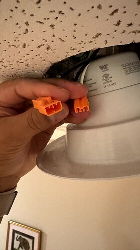

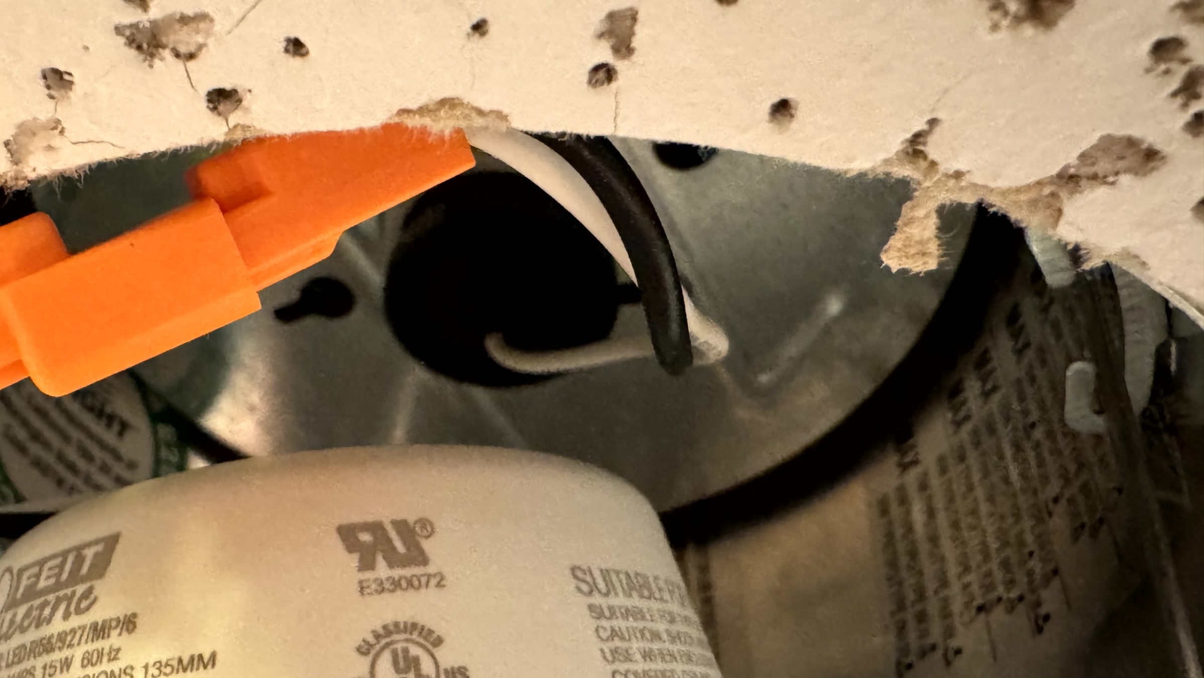

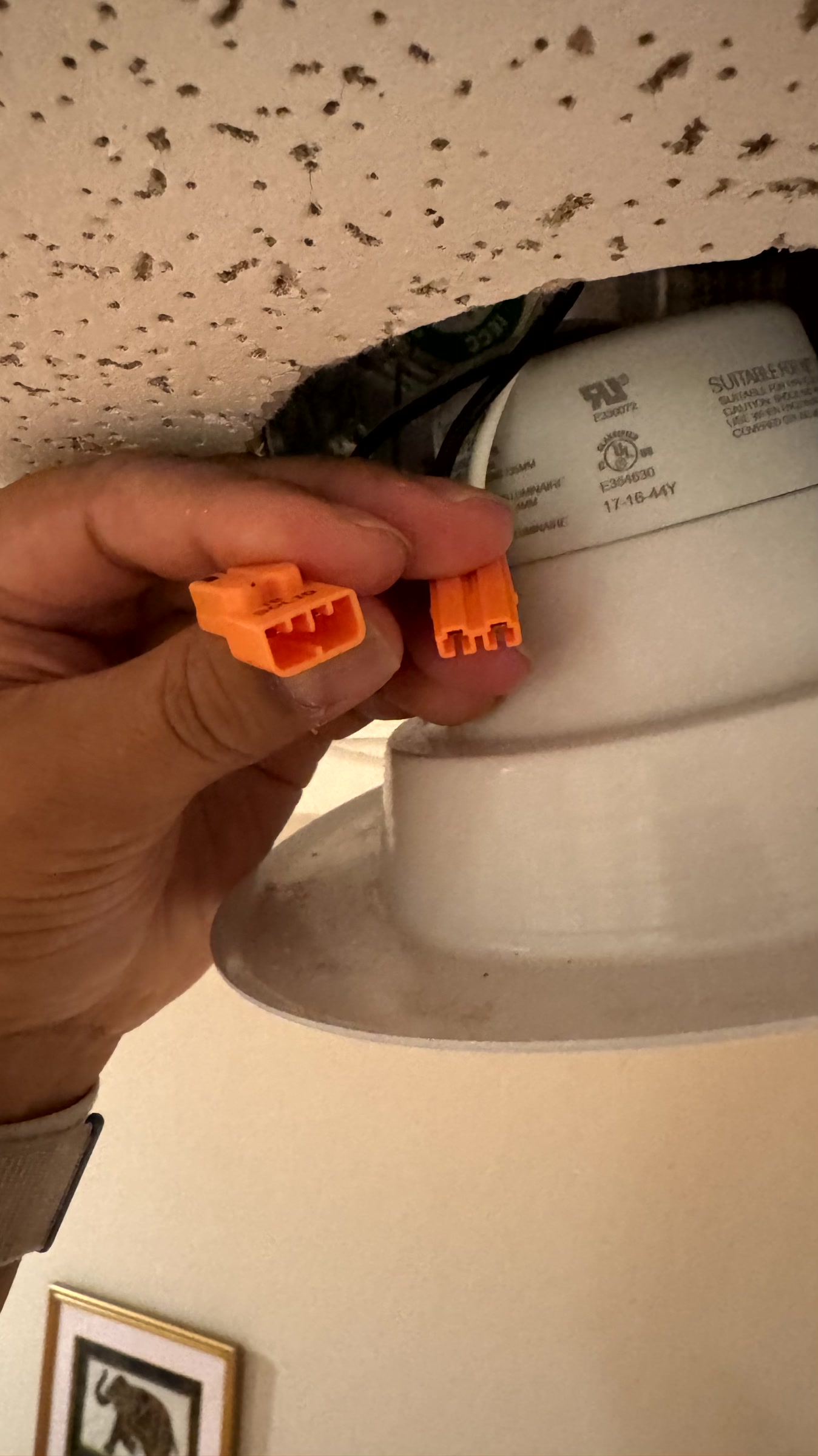

I am including pictures of the light in the can. It screws in using a standard US light bulb socket. From there, the two wires have a connector for the actual light. So far, I've been disconnecting the connector to get the light off when needed and reconnecting after.
Request for ideas: What can I do to control that one light? Remember, the whole thing will be controlled by the switch, so there will be no power most of the time. When it is powered up, then the solution should be able to turn that one light off.

Unfortunately, it's harder to unscrew. And the whole thing has to be pulled down to get to either the connector or the screw. It works somewhat like this:

Junction is above the can. I could get to it since it's a drop ceiling, but with difficulty. My plan is to connect it "in between" the orange connectors. I ordered some of those too. I'll post pictures once in place.
