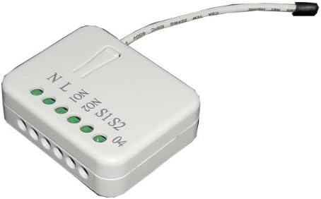

Did you ever get that PAB01 HEM working?
I'm looking at it now, but doesnt seem to work.
Yes sort of. It is reporting but that's about it.
It's currently setup using the Aeon HEM Gen5 driver.
Ideally I'd like it to have one clamp around "in bound" power and the other clamp on "Solar" generated power but I've not found a driver that displays both links.
So it's only reporting on one of the clamps?
I've really not investigated it that much. Sorry.
On a previous driver I was pretty sure it was combining the data from BOTH clamps which is NOT what I wanted.

Hey @mike, @adamkempenich, @SmartHomePrimer, @braetonpearson1, has anyone tried the "Zooz power switch" in built driver within HE, working with the Philio or Zipato smart energy meter (ZWBCSEM) device ??
I tried it this arvo and I seem to be seeing the most data that I've ever seen come back from the device.
I'm going to pull it back out of my Mains Power Board enclosure and so I can do some more controlled tests using this driver.
I just tried this, and it does seem to work, but it doesnt give individual readings based on the dual inputs. Neither does the other one, but this one looks neater.
Oh crap. Iād like to have each clamp reporting.
I wonder if @srwhite might be able to help?
Sorry, wrong person, I meant to tag: @anon61068208
I'll look at it tomorrow.
This is the driver you are using currently ?
No, I've been using a stack of them.
Currently the official: Zooz Power strip, but it only gives 1 of the two clamps. But it is adding both clamps together, and showing the combined total. (It's unaware of the 2nd clamp).
