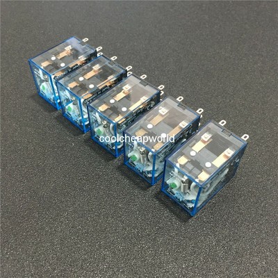

However, I just added two 110v coil relays. Only cost $9 extra. The Xiaomi dual relay independently closes each of the 110v relays, and the contacts on those 110v relays become your dry contacts. I’m using mine to close the arm and disarm button contacts for a 3V DC alarm remote control.

You might be able to find something locally that will be smaller and more suitable to the particular application you have in mind. You'll be looking for something similar to this...
Outside of Italy, you may only find larger relays like this one online. They tend to get really big when they are 220~240v coils, becuase our typical North American applications to 220~240v involve motors with a large current draw. It took me some time just to find the sort of small 120v coil relays I used. Smaller is available, but the Omron I ordered are easier to work with because I can attached connectors to the terminals and they have tabs that allow me to secure them to something. This is what I bought, but obviously, it's the wrong relay for you because the coil is rate to my local voltage.
