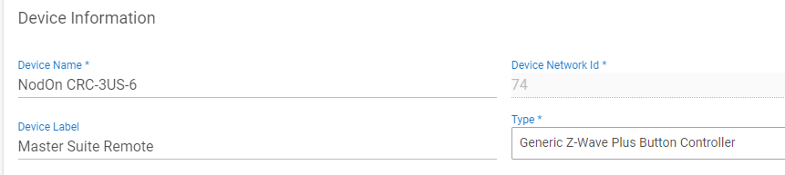

Regarding using the buttons straight up.........I notice that although I was able to select the NODON Soft Remote upon adding, it reports as a 'generic' button control in the device details. That does not seem right.

Here is the model and what driver (type) my NodOn is using
NodOn CRC-3US-6
