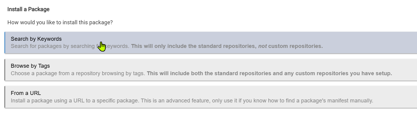

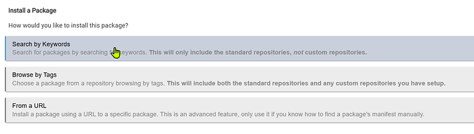

Just to note...every community driver/app is not in HPM, but many/most are. There are "release" topics in the forum here that majority of devs create for their community app/drivers, and they will usually state in the OP of their topics whether their stuff is in HPM or not.
Regardless, just takes a few moments to do a search in HPM for a driver/app you've heard about and want to try. :slight_smile:
