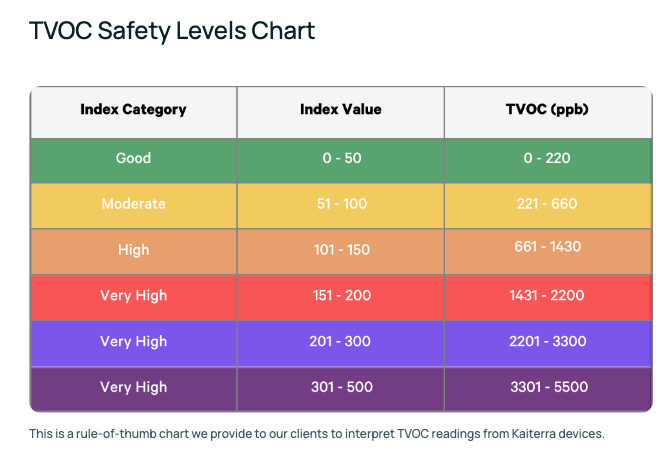

Is it based on this chart from Understanding TVOC: What You Need To Know About Volatile Organic Compounds
If you look at the driver itself, @kkossev put in a link to the chart being used:
With that being said, I still don't really know what it's measuring. I seem to get really high index values that don't really correspond to smells or pm25.

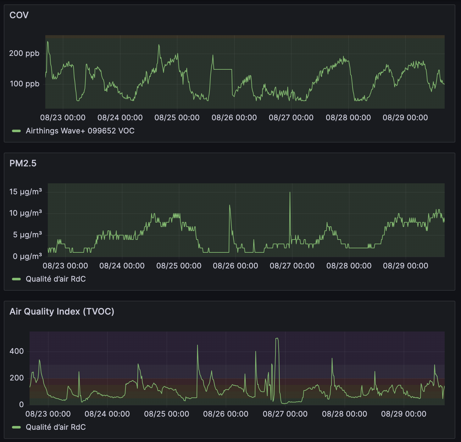

After a week of using the Vyndstyrka, I'm not sure I trust the Air Quality Index at all... it routinely goes into "hazardous" (very high) levels of TVOC... just from making toasts or cooking spaghetti sauce. If that's enough to bring the air in "hazardous" zone, I don't know what hazardous means...
Above are the plots from the VOC (in ppb) as measured by my AirThings device, and the PM2.5 (in ug/m^3) as read by the Vindstyrka, below is the Air Quality Index, which is supposed to be total VOC...

Ah, so it is not the AQI as linked before [AQI Basics | AirNow.gov], it is a "VOC Index". AQI typically has nothing about VOC.
I would say that the driver is misleading then. It should not show this data as airQualityIndex, but rather as VOCIndex or something like that.

Do you think that the 'Index Category' value from the table that you linked corresponds to the "Index Value" as measured by the Ikea sensor?
I do not think they are the same scales. That one was from another vendor, Kaiterra. It seems to be an absolute scale (50 or less is good, 51-100 is moderate, 100-150 is high, …)
