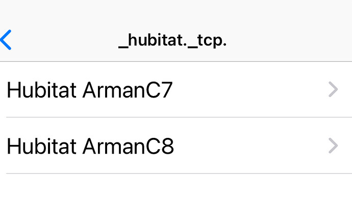

I just noticed while looking at the Discovery App, that in addition to my Hubitats being listed in _hap._tcp,
They also appear here:
Anyone know what this is about?
Isn’t that the Hub Mesh? TCP
I have Hub Mesh sharing several devices, but this entry comes and goes. Mostly goes.
