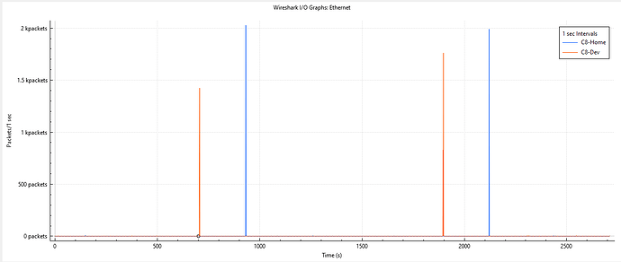

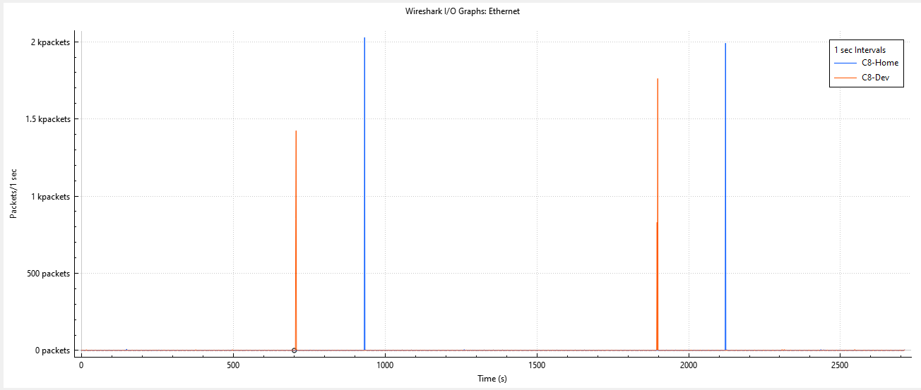

Finally decided to just get Wireshark setup and a little chart going. Did not take long to catch two huge MDNS storms all coming from my C8 hubs.
Is there any way to mitigate this so it does not lag the entire network? Can I block MDNS on the ethernet port with a firewall rule or something? One of the hubs is on Wifi so no idea how to block that unless I do it by IP I suppose.

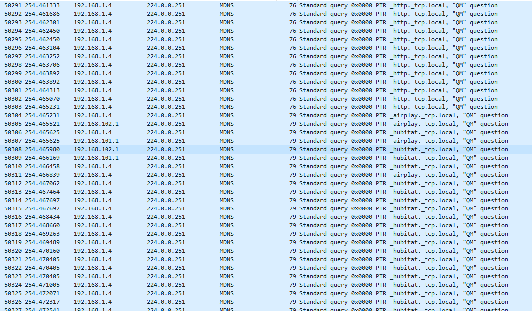

Its is just thousands and thousands of this junk from each hub:

Is there a specific interval to these spikes?
Looks like its 1200s (20 minues) apart on both hubs.

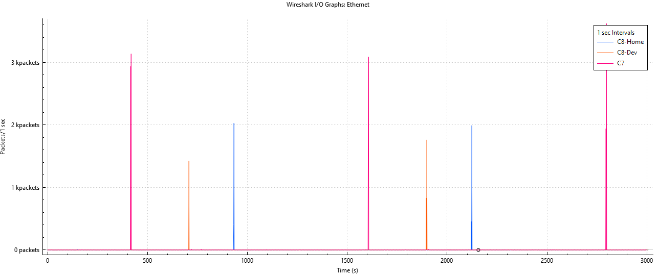

Actually now just realized I was missing some spikes on that chart after my RDP froze again. My very idle C7 hub seems to be the worst. Still right around 1200s apart consistently with all 3 hubs.
Also looks like it builds up steam over time possibly. I shut down my C7 hub and rebooted the Dev C8. The Dev hub spikes are MUCH shorter now compared to the main hub which has been up for 5 days now.

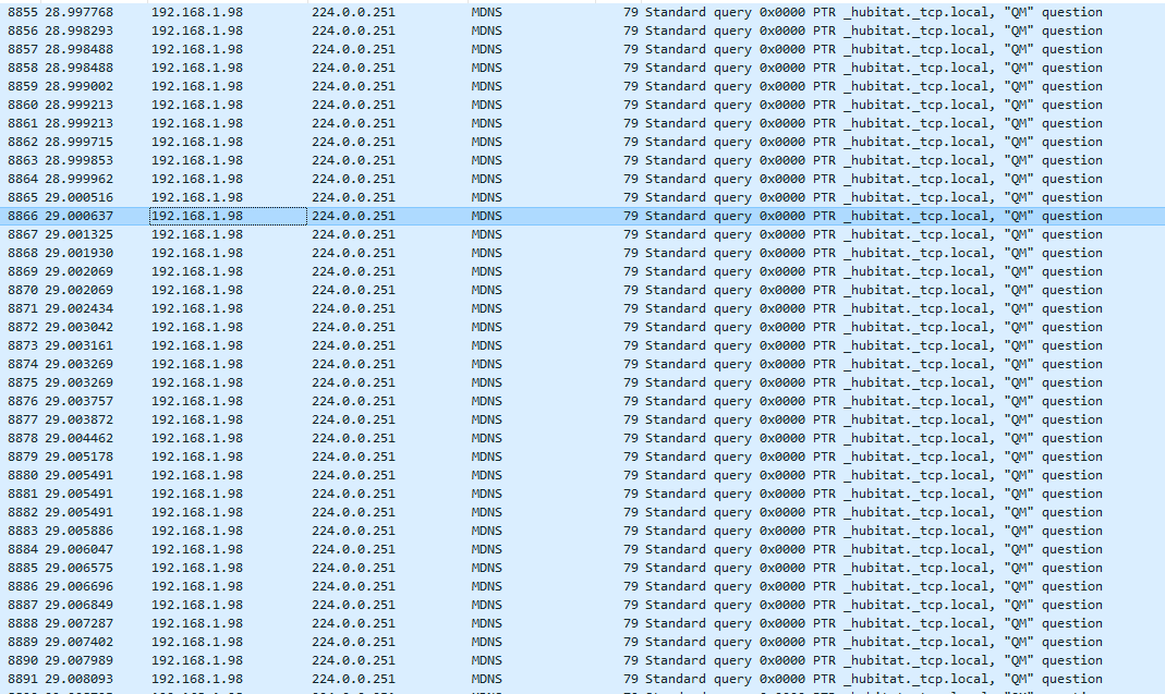

Initially it was a big problem. It got whacked down in one release, but over time, most has been put back, apparently. Wireshark, a few moments ago, confirmed that I'm seeing thousands of MDNS packets in a short time ago (2800 MDNS packets in ~2 seconds from a single Hub) which is consistent with the reports from April.

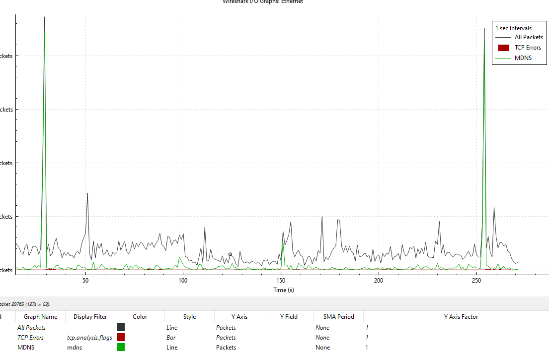

I was honestly not sure what I would find with Wireshark as I thought this issue was resolved, so I was expecting to find some other device causing issues. Ran it for a few minutes and saw some big spikes, clicked on it to check and low and behold, Hubitat mDNS spam.
So then I ran it some more and next time my RDP froze I checked the chart and sure enough, right when a mDNS storm happened.
