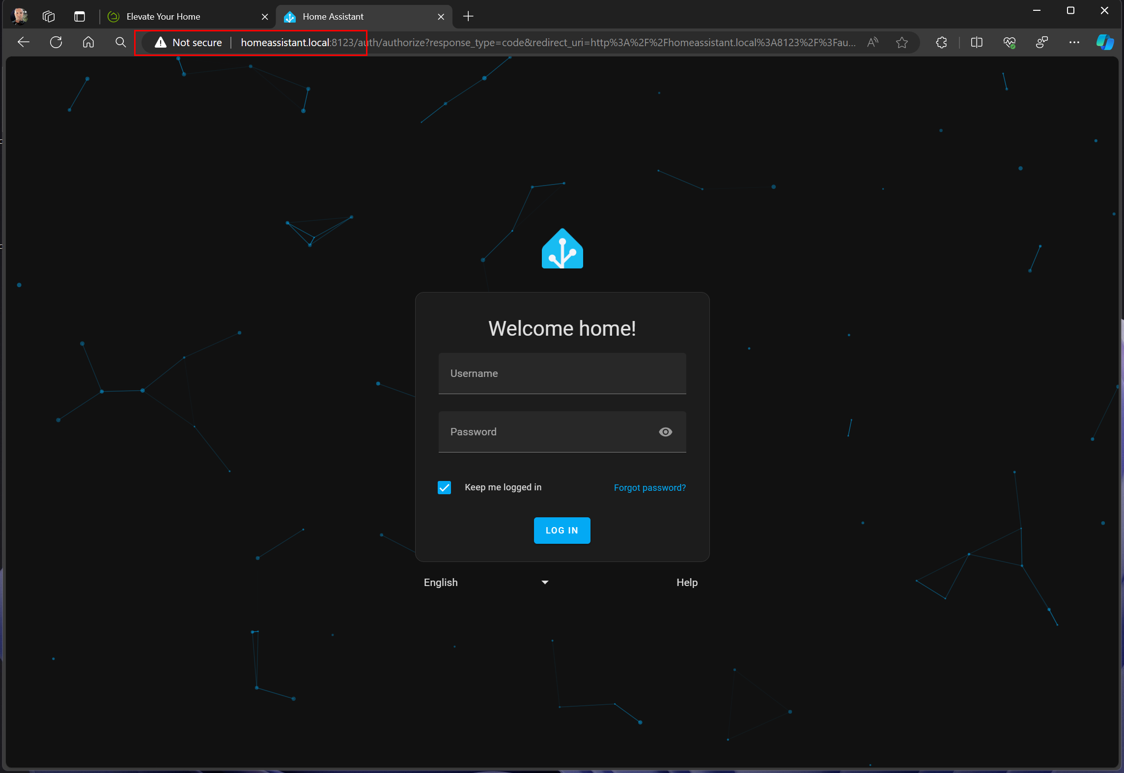

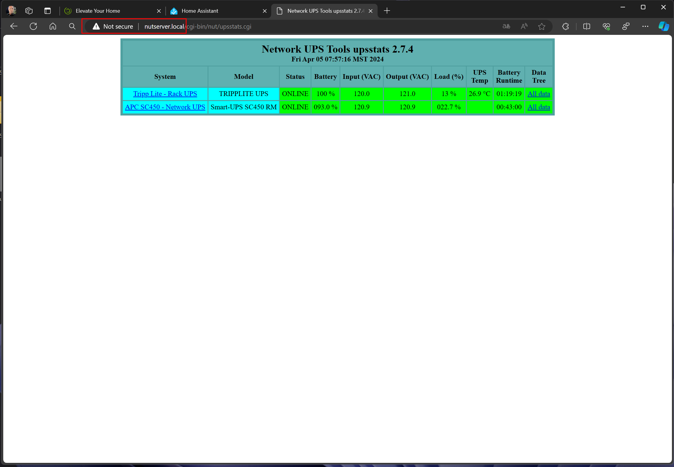

I can now confirm that it works on ALL of my Windows machines at home, whether Windows 8.1, 10, 11, or Server 2012 R2 and Hyper-V Server 2019.

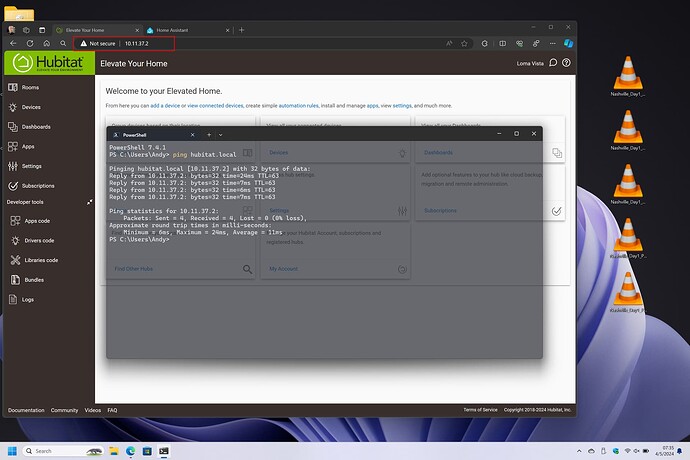

The weird thing is, it takes a couple seconds to resolve when I type the hostname.local, like it tries several other methods to resolve an IP first and then finally gives mDNS a shot when all else fails. Weird..
It should be noted too that my IOT devices like Hubitat, Home Assistant, NUT-Server, etc are on a different subnet and VLAN than my PCs, but all VLANs on my network are using the same PiHole machines as their DNS servers.

Another weird thing is that when browsing to hubitat.local in a browser works perfectly fine, but the address changes to the IP address, whereas with all of my other machines the address stays hostname.local
