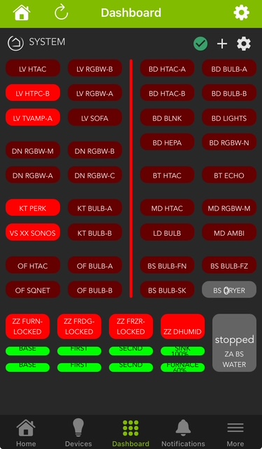

I much prefer a relatively small phone screen (iOS with display in dark mode) and find the devices tab diffiicult to use: Attempts to just turn off/on switches often result in bringing up the full screen for the device in question, and pale green vs black & white for on/off is not intuituve to me (and possibly quite difficult for people with visual impairments).
So I have created (hubitat) dashboards for various rooms: They took quite a lot of work, sizing the switches / bulbs device row/column tile dimensions to accomodate the icon plus dimmer sliders, device identifiers, on/off status text and date / time of attribute readouts etc. In addition often for a "room" dashboard, parts of my device names (helpful elsewhere) are redundant and could be abbreviated in the dashboard.

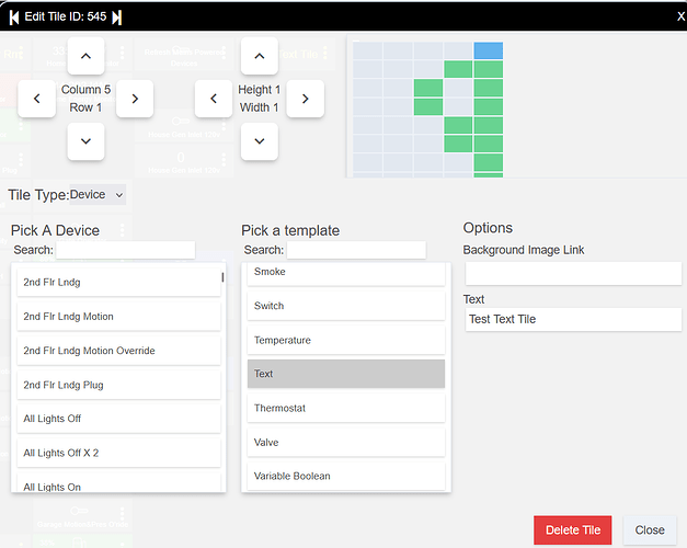

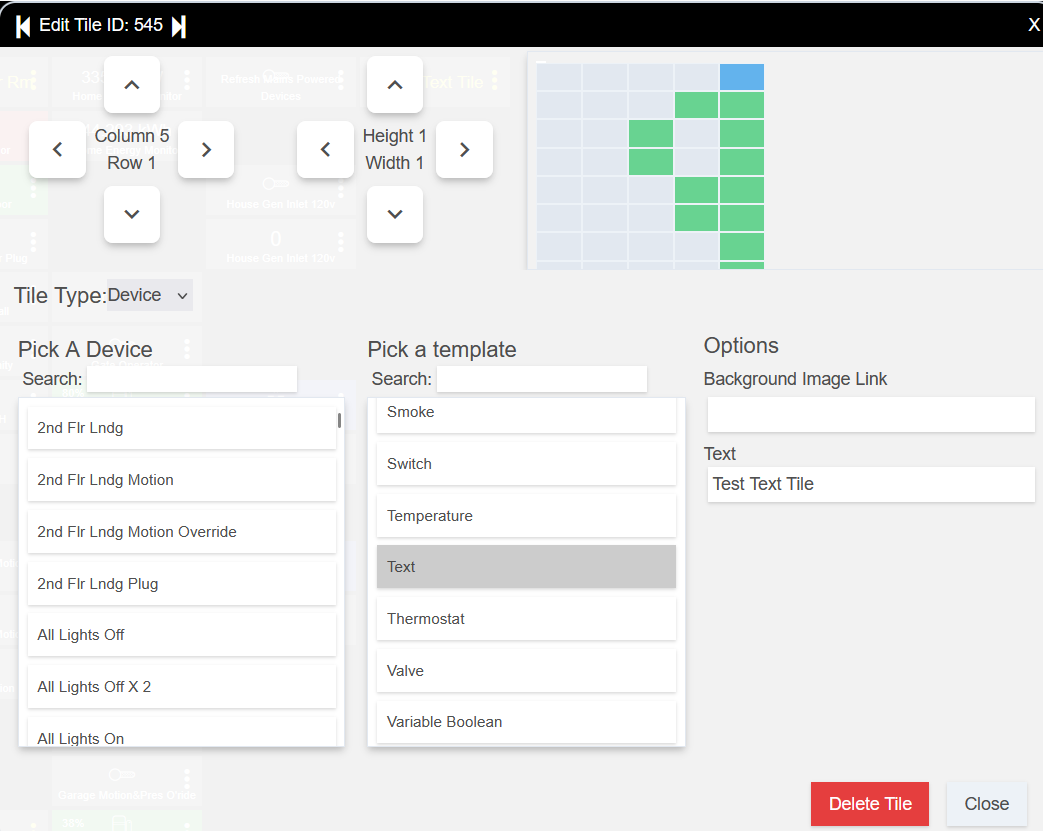

Now, in the course of your activity, you might create some phantom tiles like I did. These inhibit the drag and drop feature, and instant view of an added tile, which are very handy.

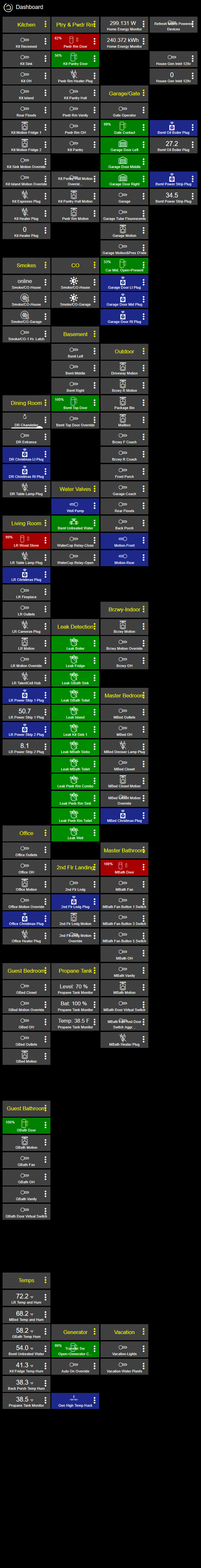

@velvetfoot: I think you are suggesting that its possible to create tiles that don't get effectively removed from the code when removed in the GUI and can perhaps cause problems but be cleaned up manually. If that's the case, I shall have to hope not to do so, but good to be aware of the signs - delete and start again will be the solution. It was somewhat dificult to place tiles with such a large dashboard, but so far the dash appears to be behaving. I see you created area/title tiles - I haven't figured that out yet but I don't think I need that right now given the limited space of a small phone screen. My no coding "master" dash relies on tweaking the grid gaps, font sizes and going back to edit all my device labels (transferring device info from label to name). It lacks a background visual cue for power draw and water running attributes but I can live with that . It's a house of cards with elements (dimmer slider etc) simply hidden by the small tile size. I don't want to think about transitioning it to a new (involuntarily larger screen) phone in a few months! Maybe that's when I casually stroll into the Tile Builder rabbit hole
Here's my final (for now) dash ... thanks again for all the help getting there most appreciated.
